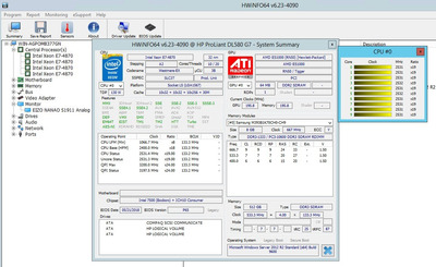

Tried also latest hw info beta version on my DL585 G7.
Almost no complaints.
Maybe the memory type could be shown? The speed is shown correctly 800MHz (DDR3 - 1600)
It's DDR3 Registered ECC.

Thanks. This machine is using some proprietary method to access the DIMM SPD, might be some dedicated switch or a protection mechanism. I will see what I can do, but it's quite unlikely that we will be able to determine how to access this.

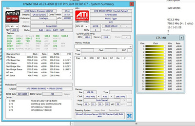

Here for HP DL580 G7:
Half of the DIMMs (32) are identified, machine has 64 x 8 = 512GB RAM
160.73 KiB
1069 views
I will add the debug file, too.

Reply 163 of 683, by Mumak

Thanks! Could you please attach a full report file (HTM or LOG) with sensor data ? You'll need to open the sensors window too for this to be included.

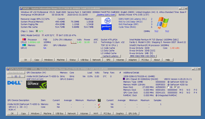

Hi, I've got another headache for you 😀
Laptop Dell Latitude D800 with Pentium M and Geforce 4200. Problem is that it doesn't report GPU clocks correctly. There should be 200mhz on gpu core and 400mhz on memory. I've altered values via overclock features and memory is just not X2 here, instead of 400mhz its 200mhz. And gpu core is completely wrong, though values change when I alter overclock, for eg 200mhz = 24mhz and if i set 150mhz = 18mhz

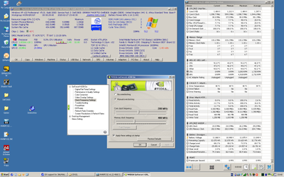

Reply 168 of 683, by vorob
AIDA also report GPU Core clock wrong, but memory is okay.
Lame question. Can you explain why effective memory clock is 400mhz while it's base clock is 200mhz?

Reply 169 of 683, by Mumak
vorob wrote on 2020-02-27, 20:45:
HWiNFO reports the memory command clock (not effective clock which is double that for DDR) and I think this is also what AIDA reports. So as long as the value in HWiNFO * 2 matches what NVIDIA reports, it's correct. Important is that the value correlates with different clock values.
As for the GPU clock, I will check that...

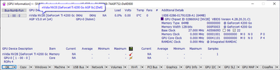

And for me! I think I might know how we can fix it, but need to checkout what is in some registers. Using the attached SIV32L 5.47 NV28-01 please post Menu->Machine->GPU Info so we can check what's in the alternate registers.

Here you go 😀
Also take a look that GPU Title is cut because of name length. Anything can be done in your interface to prevent this? Thx.
p.s. if we will be able to fix it, can you tell AIDA64 dev, so proper gpu core values will be there also?

Thank you, I could make the GPU field wider, but this would make the panel too wide on systems with small screens. If you hover the mouse over the GPU Title there should be the full name in the tooltip.
The two registers I wished to check contain zero, so it must be something else. Once I fix this I will mention it to the AIDA64 developers.

Thank you. We will have to look some more at the datasheet to see if we missed something, but I used the save files to show you the tooptip.

    Tooltip shows the full name

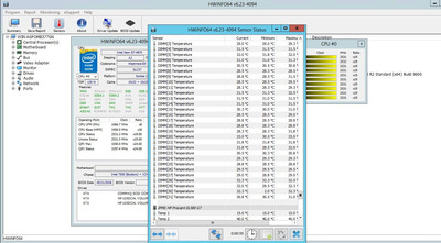

Hi again,
could you please try this build: www.hwinfo.com/beta/hwi64_623_4093.zip
on the HP DL580 G7 (Xeon E7)? I expect it now to report all DIMMs and DIMM thermal sensors too.

Sure, Looks quite good, but I can't find DIMM thermal sensors. Did I overlook it?
In the attached zip file, there should be the debug file and the htm report.

Thanks! It looks like there are some issues that I need to fix.. Will post a new build shortly.

Please try again with: www.hwinfo.com/beta/hwi64_623_4094.zip

Sure.
Now there are temperatures for the first 32 DIMMs
