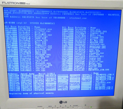

Looks like NT4 wasn't as kind to HWiNFO as Win95 was. BSOD when analysing hardware during app start.

Thanks. I think I found this bug, going to fix it now.

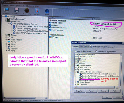

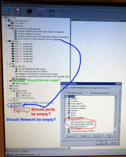

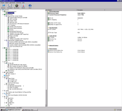

HWiNFO v6.25_4137 ran OK on NT4 this time. I see there's quite a bit more information under ports and other headings now.
70.29 KiB
720 views
I was wondering about your min/max FSB listings though - where they come from and why they are set as such? See comments in photo.
33.24 KiB
720 views
The CPU bench score is not available t the first time running for some reason.
16.7 KiB
720 views
Also the FPU score is substantially lower when running NT4 compared to Win95c. Why is this? But if you look at the screenshot from above, the FPU result was the same as the CPU result. I was also wondering why the disk drive benchmark is greyed out.
23.69 KiB
720 views

The FSB information shown is deduced from actual clock measured / ratio. It is quite off because the measurement can't be precise enough on such systems. I guess similar applies to the benchmark score, but I will have a look at that at sometime later once I resolve the more serious issues..
Could you please run HWiNFO32 twice on the machine and attach a new DBG file from the 2nd run? This is because during the first run HWiNFO enables CPUID instruction and I assume this is somehow causing an issue in the DOS version..

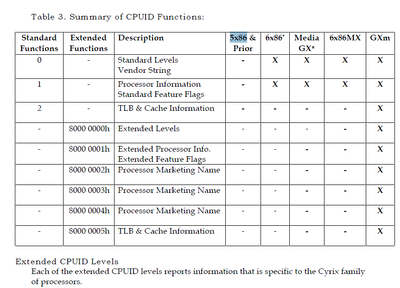

Also, if you take a look at the Cyrix CPU Detection Guide, you'll see that the 5x86 doesn't even support the standard CPUID functions.
