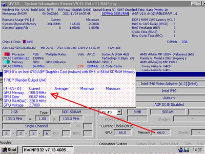

Reply 542 of 683, by red-ray
Good and fingers crossed you have. I ran HWiNFO in the hope of checking we all reported the same Intel i740 clocks. Looking from Re: Need help to improve the support of 486/586/686 class CPUs in CPU-Z both AIDA64 + SIV report a memory clock of 100 MHz, but running HWiNFO32 on WMe it reported 66MHz, it was also much to big for the 640 x 480 display.
I also looked at https://vintage3d.org/dbn.php#sthash.VE9XlzHm.7wJJHkXn.dpbs and it has the i740 memory clock as 100 MHz, what do you think it should be?

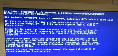

v7.14 portable crashes on loading - enumerating devices. Hangs up on USB detection. I have the motherboard's onboard Intel USB 1.x port enabled, as well as a USB 2.0 PCI expansion card installed with NEC 720101 chip.
Windows 2000 SP4
Intel PR440FX dual socket 8 motherboard with two PIIOD -333 installed
debug file attached.

It crashes during enumeration of the NEC USB controller. Is this a hang when HWiNFO stops responding and can (or cannot) be killed?

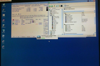

It leads to this pretty blue screen.
FYI, the BSOD occurs with AIDA64Extreme600 as well, but only if I click on the USB item from within the program. if I don't click on the USB device, I can use AIDA as usual. The information contained in the blue screens produced by hwinfo and aida are identical.

I can still access files on a USB flash drive using the NEC device. Is there a way to tell hwinfo not to probe USB?
Reply 551 of 683, by Mumak
feipoa wrote on 2021-11-19, 11:32:
Basic functionality probably works but the driver doesn't seem to properly handle additional query functions, it should in no way cause a BSOD when an application queries it.
Currently there's no option to disable USB scan, but it's not performed in Summary-only or Sensor-only mode.
I will add a dedicated option to disable USB scan in the next build.

Next build of HWiNFO will allow you to skip USB enumeration if you insert "UsbEnum=0" into the INI file. This option won't be exposed via GUI yet.
