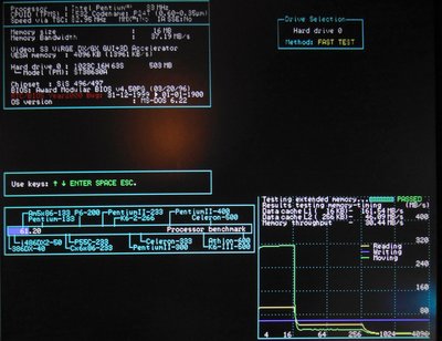

I've been doing some bench marking on my socket 3 motherboards and I am consistently getting low memory bandwidth from speedsys. I am using mostly the same components when testing these boards.
Example, the MS-4144, I was using a 100MHZ OD Intel and decided to try the POD83 and it made no difference. I've been trying different settings in the bios, mostly 0WS and 1 CLK sometimes 2 if the board hangs at boot.
I've been using a 16MB stick of FPM. I tried a few different sticks and see no real difference. I got roughly the same results on an ASUS and a Lucky Star LS486E and Soyo 4SAW2
I did notice on some boards where the cache is disabled I'll get over 100 MB/s on the bandwidth. I have also tried different brands of 15NS and 20NS cache sticks always testing with 256K.
I have MS-DOS 6.22 loaded on a 8GB hard drive.

Using a paired set of ram sticks made no change on the bandwidth results. I tried disabling the cache and did another speedsys and the bandwidth went up to 110 MB/s.
Reply 5 of 16, by bakemono
I have also seen the situation where memory benchmarks are higher when cache is disabled. Some chipsets suffer extra latency when there is a cache miss. But sometimes this only happens when the L2 is set to Write-Back, but not on Write-Through.
100MB/s is pretty high for socket 3.

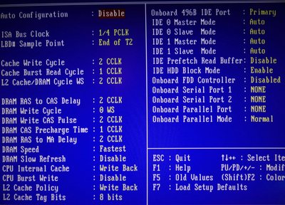

Reply 6 of 16, by cyclone3d
What happens when you enable "DRAM Slow Refresh"? Contrary to how it sounds, it should actually increase the throughput and lower the latency. The more time between the forced refreshes, the less wait their will be between reads and writes. It just depends on if your RAM will handle the longer time between forced refreshes.
What about "CPU Burst Write"?
What about trying "Write Through" on the CPU Internal Cache and /or the L2 Cache Policy?
I don't actually see anything about interleaving on that BIOS screen.

Reply 8 of 16, by Turboman
Update on the testing. Setting the CPU to WT had no effect. CPU burst mode on the mobo would hang every time even with different settings in the bios so that stays off.
Setting the cache on the mobo to WT......
Bandwidth now at - 110.06!
L1 - 161.51
L2 - 44.48
Throughput - 37.64
I put the CPU back in WB, that had no effect on the speed. Setting the Dram to slow refresh had a small increase.
Bandwith 112.08
L1 - 45.32
L2 - 38.20
I tried both a pair of sticks and one stick that had no change on the speed. Also before the FPS in 3Dbench went from 64.1 to 71.2 now with the cache on the mobo to WT.
I thought WB was supposed to be faster? would that be effect be chipset specific? One thing to think about, these 4 motherboards that I was testing are all SIS, I wonder if that is why?

Reply 11 of 16, by j^aws
^^ It's quite conceivable that the BIOS writers mislabelled the WT/ WB options and these are actually swapped. If you can't find these BIOS options, try looking for a jumper on the board that is equivalent.

Reply 14 of 16, by Turboman
alvaro84, I was wondering if it matters from what you said, I did more testing and found that it does. This can be seen in cachechk to confirm and doom.
Another Asus mobo, using all the same peripherals with the L2 cache on WB in the bios
Memory bandwidth 37.55 MB/s
L1 - 155.53 MB/s
L2 - 38.00 MB/s
Memory Throughput - 30.97 MB/s
Memory speed in cachechk 16.8 MB/s
Doom FPS 38.0
L2 Cache set to WT in the bios
Memory bandwidth 112.16 MB/s
L1 - 162.54 MB/s
L2 - 45.01 MB/s
Memory Throughput 38.00 MB/s
Memory speed in cachechk 36.6 MB/s
Doom FPS 40.6
From what I am experiencing L2 cache on certain mobos being set to WT is faster then WB. I'm not sure what else could be tested to see the impact on performance.
