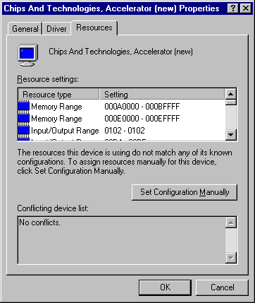

I'm running Windows 95C on my Toshiba Satellite T2130CS. 486DX4-75, 24MB RAM, 4GB SD to IDE adapter. Yeah, I have the passive screen, and it's not great as-is, but it'd be nicer if I could push higher than 256 colors to it. For whatever reason, though I have 1MB of VRAM (to be fair Speedsys detects it as only being 960K) when I try to set it to 16-bit color and reboot, it's in 16-colors and complains that my settings are invalid. It's got, near as I can tell, a Chips and Technologies 65545 accelerator in it, and the appropriate driver is installed -- supposedly this is even the very version Toshiba would have preloaded on this machine when it left the factory, but its factory preload of Windows is long gone. Device Manager says some suspect things about I/O ranges, but it says this (and refuses to run in hi-color mode) whether I'm using this driver or really any other -- I've tried a generic 65525/30/35 driver, this driver, and the built-in Windows 95 driver for the C&T accelerators. I've attached the device manager window with the clues I'm seeing, but it did this same thing on Windows 95 A when I tried it. The Toshiba utilities (which I did manage to find for this model, on their website no less) say the screen has two color modes, 4k and 222k, and it's in 222k, so it's not the screen causing issues ... though I have tried several monitor drivers and currently am using the Laptop Display Panel - 800x600 driver.
Reply 1 of 17, by derSammler
Remove 8 MB of RAM. I own a 486 by EPSON with the same graphics chip. Windows 95 is unable to use more than 8-bit with this graphics chip when you have more than 16 MB RAM installed. No idea why.
Reply 2 of 17, by Sedrosken
Not really an option, sorry. I can do 24MB or 8MB, nothing in between. It's got 8MB onboard and the module is for 16MB. Oh well. 256 colors it is I guess. I wonder if Windows 3.11 has the same issue?
Reply 3 of 17, by Scali
Are you trying to set 16-bit colour at 800x600? That might not work on a 1 MB card (pretty sure it didn't on my Speedstar Pro VLB 1 MB). Did you try 640x480?
Reply 4 of 17, by derSammler
800x600 @ 16 bit needs 937.5 KB of video ram. So 1 MB is enough.
As I said, I know this problem and it is caused by more than 16 MB RAM. Should jaZz_KCS read this, he can confirm the issue. He found it as well.

Reply 12 of 17, by jaZz_KCS
I can confirm the strange quirk regarding C&T65545 chipsets and more than 16MB of memory resulting in the official drivers not working above 8 bits.... As well as other acceleration related weeaboos happening. I have experienced similar behaviour on my cash register 486 that has the same chipset. When installing more than 16MB of memory a certain range of features of the C&T65545 are not working anymore resulting in the following errors (that I can remember):
- Upon booting W95, it will say the GPU driver is incompatible and you have to choose anew. Even when selecting the same one as before, the higher bitmodes as well as resolution seem to be unavailable / crash upon try.
- Upon booting W3.1, it will crash with the C&T65545 driver selected.
- DOS VESA modes of various kinds cannot be intitialized and games that were working before (for example with SciTech or UniVESA or alike) do crash/exit. Basically VESA support is botched in a big way.
There were others that I cannot remember

Reply 15 of 17, by Sedrosken
Tried 8MB on both. Doesn't fix the issue. I might look into Scitech to see if there's anything I can do, but at this point I mostly consider the matter solved if not exactly satisfactorily. Given that Device Manager warns that the IO addresses are in non-standard locations, Scitech may be able to do something. What's a good version for Windows 95 and a 486?

The theory that the card only has an 8-bit DAC seems likely now.
If that theory is true, then the card will only support palette-based modes, with 256 colours max. And it could be that the BIOS actively blocks any other modes, because they would not work.

Reply 17 of 17, by keropi
I have checked the datasheet and the 65540/65545 controllers have integrated truecolor ramdac but via registers they can be limited to support old flatpanels and their color depth - the datasheet states some dstn ones that have 256k color limitation and newer ones that support the full 16,7mil range.
Maybe the panel used in this system only supports 8bit and thus the controller is locked to that for the internal flatpanel. If there is an external vga port there is a good chance it will support higher color depths.
