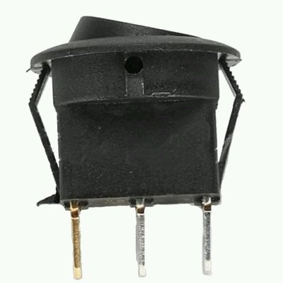

I want to wire a on/off toggle switch onto a jumper (actually the address selector jumper on the PCMIDI card). I suppose it applies to any other jumper you want to be able to easily open/close.
I have attached a photo of an example switch.
There are three connectors obviously....do I connect 2 of them to the jumper wires, and the third to ground? Is it clear which is which?

Reply 1 of 9, by wiretap
I don't know the model of that switch, but it looks like it is for supplying power to a switched load or has an illuminated surface. You won't need power, and definitely don't tie it to ground. You'll want to use a multimeter to test which leads have continuity when you switch it on and off. The switch you show can be used, but it would be much cheaper and easier just to use a simple toggle switch with two leads. Then wire them to the two jumper leads.

Reply 3 of 9, by mdog69
You first need to identify which of the three terminals is "common" - two methods here:
1) Look at the switch and look for a terminal marked "COM" or "C"
2) Use a continuity tester/buzzer/bleeper or a multimeter. Put one probe on the centre pin, and another on the left pin. If you don't get a beep, operate the switch. If you still don't get a beep, then the pin you weren't probing is common. If you do get a beep, operate the switch and move one of the probes to the other pin. If it beeps, the probe you didn't move is on the common pin.
Secondly, look at your jumper header.
If it has two pins (i.e. the jumper is "ON" or "OFF"), connect the common terminal on the switch to one pin, and one of the other terminals on the switch to the other pin. Leave the third pin on the switch unconnected (and put some insulating tape on it).
If the header has three pins, and has two positions (for example 3 pins labelled 1,2 and 3, and the link is set to 1-2 or 2-3), connect the common terminal on the switch to the central pin.
Connect the two other pins to the outer pins of the set of three (for example for 3 pins labelled 1,2 and 3, connect the common terminal to 2, and the other terminals to 1 and 3).

Reply 4 of 9, by derSammler
These 3-pin switches all work the same. The center pin connects to either the left or right one, depending on the position of the switch. It's a toggle switch. When switching, one closes and one opens connection to the center pin.
So you connect the center pin and one of the other pins to the 2 pins of the jumper. That's it.
Reply 5 of 9, by kolderman
@mdog69 thanks, I have no idea it would be this complicated. The jumper is just two pins, I.e. open close. I was hoping I could just find a simple toggle switch but they almost all have three connectors. It seem I underestimated the humble switch.

Reply 9 of 9, by kaputnik
T.J wrote:
mdog69 wrote:
T.J wrote:
Try looking for a SPST (Single Pole Single Throw) switch, they are either open (off) or closed (on) with only have two terminals and are pretty much the switch equivalent to a jumper - if your in the UK something like would do the job.
https://cpc.farnell.com/pro-power/ppw01075/sw … t=spst%20switch
Looks like the OP has already got a SPDT (single pole double throw) switch in a style they like, which will do the job just fine.
Sorry, must have miss-read some of the op's posts - got the impression the rocker switch wad only an example and ideally they wanted one with two terminals rather than three for ease of installation.
Well, it's not harder to use the one pictured in the OP. Just use the common pin in the middle, and any of the other two. Leave the last one unconnected 😀
