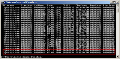

karakarga wrote on 2022-11-25, 21:14:
!!! Asus P2B-D is a 440BX based dual Pentium III mainboard. It won't include any Tualatin microcodes, upto cuppermine! https://soggi.org/motherboards/asus/P2B-D.htm
And yet here they are:
112.24 KiB
1177 views
The presence of a certain microcode update by itself does not imply CPU support. ASUS often included microcodes for CPUs that were not supported by the board. Example: The CUBX BIOS contains microcode updates for Slot 1 CPUs, which doesn't make any sense at all. But they don't do any damage, so the engineers probably didn't care.

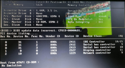

a_h_adl wrote on 2022-11-26, 01:42:
I tried to do the same on a bunch of Gigabyte motherboards with no luck. The use of CBROM and CTMC part was easy enough but I was stuck at editing the file's header section after adding the microcode to add a pointer to the newly added ones. Maybe Gigabyte header uses different addressing formula or I just missed something simple?
I only tried a BX2000+ thus far. Its microcode file was just all single microcode updates strung together, without any header structure. (As far as I know, this is the usual way, and the header format is an ASUS speciality.)
Haven't looked at the others yet, but I would expect them to be the same.
I couldn't boot the GA-6BX7 with Tualatin's, maybe the board needs recapping as it is a typical Gigabyte plague for the boards of that era but the other two boots to windows with no issue with Tualatin CPU's but not with updated microcode.
If the board does not boot at all, it's most likely not a microcode issue ... could be hardware-related, but could theoretically also be an incompatibility in the BIOS code.

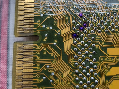

Reply 136 of 394, by karakarga
a_h_adl,
I have removed 4 pins by opening Asus S370-133 adapter and removed total of 4 contact pins inside the socket to run Tualatin. If you can isolate those 4 pins, it can be OK as well. Some people cut Tualatin processor pins, again risky.
Some people put removed cable part of plastic, (for example from telephone box remains at streets left as trash, they are really thin). You may wear those plastic parts each, about ~3 mm long to that 4 pins, and insert the processor on the 370 socket like that. This is safe but, difficult to find such a cable!
But, if you do that pin pull out modification, normal processors like Coppermine etc. and others -- Do not work again after that mod -- only Tualatins!
If, it will not work for Tualatins, mainboard can not open with any processor, (when removed those 4 pins). This is quite risky!
Reply 137 of 394, by a_h_adl
karakarga wrote on 2022-11-26, 13:15:
a_h_adl, […]
a_h_adl,
I have a few pin-modded tualerons and 1400-S from the Korean supplier and also Lin-Lin adapter which work well on my original slockets. But thanks for the info anyway!

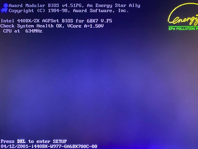

Reply 138 of 394, by a_h_adl
DenizOezmen wrote on 2022-11-26, 07:52:
The boot screen freezes at just before memory check:
123.96 KiB
1107 views
I checked the VRM and frequency generator chips and they can provide voltages down to 1.3V and up to 150MHz FSB with no issues.
The above photo is for SL64V (Intel Celeron 1.4 GHz) CPU, the board provides the right voltage (1.5V) but wrong FSB (66.6MHz x 9.5 =633MHz). The 9.5 multiplier is the max supported by dip switches but that shouldn't be an issue IMHO.
I can confirm the board works nicely with lower frequency CPU's at 100MHz FSB with no issue, but gets confused with the tualeron one.
It does exactly the same with SL6BY (Intel Pentium III 1.4GHz-S).
