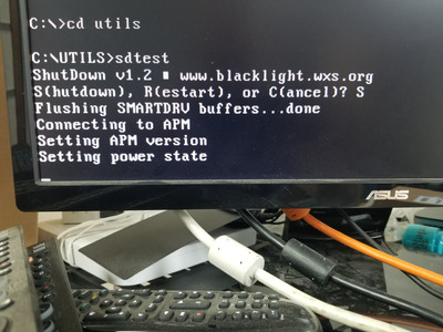

Reply 189 of 394, by DenizOezmen
maxtherabbit wrote on 2023-01-27, 23:48:
Interesting, do you know if it would be possible to enable a hidden setting in the BIOS to disable ACPI outright perhaps?
There are no interesting hidden menu items as far as I can tell. Maybe it's possible to neuter ACPI by removing the ACPI tables module. The test build below does that.
The shutdown utility is whichever one is included in the CDU release package of MS-DOS 7.1 (on REMOVED)
Thanks! Yes, this tool uses APM functions through int 15h.
I don't think ACPI per se is the problem here. It seems like all methods (setting power states through ACPI or through APM int 15h) boil down to the same mechanism: A write to the APMC register of the southbridge is performed, which causes an SMI. The SMI handler reads the command from the register and chooses an appropriate handling routine. The routine for performing a "soft off" (assuming I found the right one) is pretty long-winded and has multiple interactions with the power configuration and probably the SMBus(?) I/O space of the southbridge.
Could you try the attached test version of the shutdown tool? It should print some additional messages. I suspect it to hang after printing "Setting power state" ...

Reply 190 of 394, by maxtherabbit
DenizOezmen wrote on 2023-01-28, 13:29:
There are no interesting hidden menu items as far as I can tell. Maybe it's possible to neuter ACPI by removing the ACPI tables […]
The shutdown utility is whichever one is included in the REMOVED release package of MS-DOS 7.1 (on REMOVED )
I suspect you are correct about the shutdown problem, I will try both of these test versions and get back.
Truth is, the shutdown thing isn't really my concern. My concern with ACPI is that neither WinXP nor Win2k will even install without forcing a non-ACPI HAL. They just hang in the installers. Most live linux CDs won't boot either, notably including Acronis true image 2011 which usually works on everything

Reply 191 of 394, by DenizOezmen
maxtherabbit wrote on 2023-01-28, 14:55:
It's likely all somehow connected. Regarding Windows, it might also be possible to force APM installations by setting back the BIOS build date. No idea if Linux distributions have a similar mechanism.
Your suspicion confirmed
1.56 MiB

maxtherabbit wrote on 2023-01-30, 20:59:
Thanks for checking!
@maxtherabbit: Could you test this one if you find the time?
