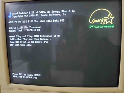

Could you possibly implement these enhancements to the official ASUS P2-99 BIOS? It is the budget version of the P2B that uses the Intel 440ZX chipset.
Reply 287 of 394, by DenizOezmen
Gmlb256 wrote on 2023-07-09, 23:25:
The builds look quite similar, so it might work. Here are test versions.
In case you have the P2-99 with hardware monitor, could you check which model the IC is? I suspect it's a W83781D, but could not verify that.
[Edit: Corrected descriptions of attachments (accidentally switched "with" and "without" HW monitor)]
[Edit: Removed obsolete attachments.]
Reply 288 of 394, by Gmlb256
DenizOezmen wrote on 2023-07-10, 16:44:
Awesome, thanks! I flashed the BIOS and it worked successfully. 👍
373.4 KiB
1149 views
Recently, I'm testing a VIA C3 Nehemiah 1.2GHz with the FSB overclocked to 124 MHz. I can't use 133 MHz FSB due to the current video card not being capable of handling AGP @ 89 MHz.
No problem, mine didn't come with the hardware monitor and I downloaded the other one.

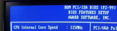

Reply 289 of 394, by Gmlb256
On a little note, the "CPU Internal Core Speed" in the BIOS setup is displayed incorrectly.

    It displays 115 MHz instead of 1115 MHz. Everything else works fine.
Reply 290 of 394, by DenizOezmen
Gmlb256 wrote on 2023-07-10, 18:06:
There's always cute surprises. 😁
I've tried fixing it in the update below. It's not tested at all, though, so it might do weird things. In case it does work, do you have the possibility to test with a three-digit speed as well?
Thanks for the feedback!
[Edit: Moved attachment.]

DenizOezmen wrote on 2023-07-10, 20:29:
That did it! The "CPU Internal Core Speed" in the BIOS setup now displays 1115 MHz properly. 😁
Yes, I did test with both PII-400 and PIII-750 CPUs as well. They displayed the correct CPU clock frequency without any issues.
