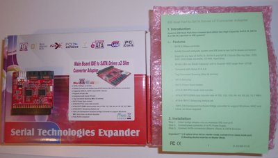

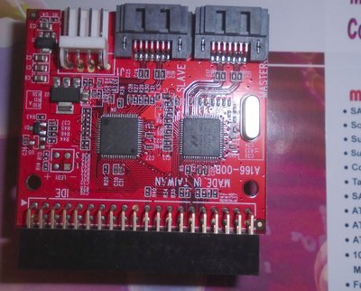

Reply 5 of 29, by PC Hoarder Patrol
The Addonics is just a re-brand of the Lycom (Marvell 88SA8052) I linked earlier. Opened a new boxed one for pics
