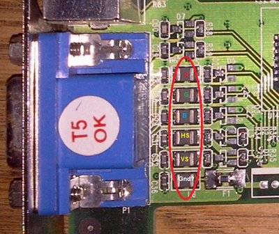

I have an old Guillemot TNT2-M64 with a strange problem.
The card can work 2D and 3D with no problem (tested under 3DMARK), but the output quality is really strange.
The card display odd horizontal ghosting (icons, windows...).
I know this is not a collectible card, but i would like to understand what's the problem and, why not, try to solve it.

Reply 3 of 6, by Tronix
You can try to short circuit this inductance (L):
164.48 KiB
631 views
I indicated the purpose of the inductances approximately. First of all, you need short circuit HSync and Vsync inductance. And if i not mistake, short GND inductance. Maybe this will help.

Reply 4 of 6, by parhelia512
Thanks for your reply !
I've shorted the three last inductances (HS VS and Ground) and no changes.
Could this behaviour come from the chip himself ?
In fact, even at boot, when the card display the BIOS version, i can see there is something wrong : lack of precision for the caracters.
