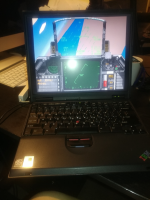

Era 1 (1982 to 1985): This is the dawn of PC gaming - The developers assumed that the hardware will always run on an 8086/8088 and popped all sorts of hardware specific tricks on the period CGA/Hercules adapters to speed things up, so unless you have one of them, the games won't run entirely correct.
The audio is via the one-channel PC beeper (unless it's specific manipulation directly off the hardware, which is usually very CPU hungry.
IBM PC/XT gaming are a bit of a niche, and the games were…mostly eye searing with chirps of silicon pain. Me, I prefer to stay out and stick with Apple ][ or C64 emulation here.
Laptop specs typical of that time: What's a laptop? Seriously, not much here until the 486DX4 (late era 2) machines came out.
Recommended machines: Either play on an oldschool PC/XT or DOSBox.

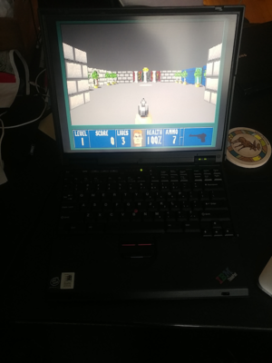

Era 2 (1986 to 1993): These are the years when PC gaming starts taking mindshare from the C64/Amiga/Atari ST kids, and comes into their own against the 8 and 16 bit consoles.
We can begin with a 80286-16 AT clone with Gunship 2000 and go all the way to, say, a 486DX4/120 with the 7th Guest, Stunts or Novalogic’s Comanche. The era starts with EGA 16 color graphics and standardized on 320x240 256 color VGA. Some headway was made towards VESA (VLB + BitBLT cards) towards the end.
Audio capability starts with the PC speaker and went from Tandy 3-voice sound, Adlib/SB/OPL3 and the Roland MT32 (the lingua franca of the game music composers like George Sanger). Some real classics like Civilization, X-Wing, Wing Commander/WC2 and Rebel Assault, Strike Commander/SWOTL, Falcon 3, Master of Orion, Commander Keen/Duke Nukem, Kings Quest/Space Quest, SimCity/SC2K and Wolf3D were made in that time. OS is DOS 3.3 to late 5/early 6, maybe some Windows 3.0 to 3.1/early Win95. Gameboy and NES emulation can be done here starting with a 486/66MHz.
Laptop specs typical of that time: Portable, good laptops with gaming capabilities begin at this time, starting with 486/50 machines (like the bento box Thinkpad 701c), and typically bundled with 4-12MB of RAM. Video capability is typically 640x480 @ 256 colors (assuming 512k/1MB Chips & Technology 65545). 12mm PATA HDDs, and ends with 800x600 @ 16 Bit colors.
Integrated audio does not exist until towards the very end. I don't think 486 laptops of that era were really pushing VESA local bus that hard - as there were no Tsengs or S3 mobile cards to take advantage of it.
Recommended machines: Technically, these era 2 machines are actually early era 3, since you want integrated audio, some CDROM capabilities and good (not great) VGA/SVGA capabilties off your period GPU - C&T 65530/45 video chips being typical. Good machines would be like a Toshiba T2150CDT or something similar, and make sure you don’t get something DSTN (duslscan passive matrix), which is eyeball torture. I would not recommend buying a machine specifically for era 2. These machines are rare enough to command an undeserved premium on the open market. Note that when the 8 bit guy was talking about DOS vintage laptops in his video, he's really talking about an era 2/early era 3 machine which was fine for anything made between 1988 and 1995.

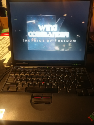

Era 3 (1994 to 1997): These are the years when "PC master race" manifests itself - late DOS to early Win95/DirecX 3. Truly landmark games were made at that time (Duke Nukem 3D, Doom I/II, US Navy Fighters, Westwood's Kyrandia series, TIE Fighter (the original gourard shaded version and the later MPC2 SVGA CDROM version), Starcraft, Transport Tycoon/TT Deluxe, NFS:SE. Towards the end there were moves into 3D capable accelerators, like the Cirrus Laguna, the S3 Virge (yes, I know about its reputation - I had a Diamond Stealth 3D 2000), the ATi Rage Pro, and etc. All that was swept up by the 3dfx Voodoo. OS is late DOS, Win95 to early Win98. You might be able to emulate up to an SNES here. Bus is ISA+VLB and some PCI.
In terms of GPUs, no 3dfx here (unless your dock supports a PCI slot, and even then there are performance limitations)
- If you are targeting for early Era 3 (DX4-120 to the Pentium 90s) you are most likely gunning for Chips and Technology GPUs.
- If it's mid Era 3 (P120 to P233MMX, Starcraft capable machines) it's probably CT65550, Neomagic 128XD or maybe a Virge MX.
- If it's mid-to-late Era 3 (P233MMX to around Katmai/early coppermine) it's Neomagic 256AV/ZX or ATi Rage Pro LT/Mobility M1.
Audio across the board should be Sound blaster "compatible", like a Cystal Soundfusion (CS4624 is okay), ESS (ESFM, gun for the ESS ES1938/46S/69 Solo-1) or something Yamaha based (OPL3).
RAM is EDO or PC66/100 SDRAM, and bus is PCI and PCI+AGP port.
CDROM inclusion started at late era 2 and is standardized in era 3.
Early Era 3 -
Toshiba 410-430CDT (good solid P90 to P133 machines)
Dell Latitude XPi
HP Omnibook 800CT
Toshiba Librettos 70 to 90CT.
These are all good reliable fleet machines - the first 2 are bigger machines while the latter 2 are more portable.
Mid Era 3 -
Dell Latitude CPi (if you want to save some money, get the CPM233XT.
It's a Pentium 233 MMX machine that can have its CPU swapped out and upgraded to 400MHz Dixon PII/Mendocino via an MMC1 module swap and the infamous TR4 BIOS trick)
IBM Thinkpad 600
Thinkpad 240 or Toshiba Portege 7020CT if you need portability.
Late Era 3 - if you want mediocre/nonexistent 3D and decent 2D support, gun for something that has a Neomagic 256AV Virge MX or Rage Mobility M1 - Compaq Armada M300/M700, CPxJ/Inspiron 3800, Thinkpad 770, Thinkpad X20/21 if you need thin-and-light.
Compq Presario 1200XL-110 or Presario 1694 (AMD K6-2, ATi Rage Pro LT 8MB, ESS Solo-1)
Toshiba Satellite 1640CDT (AMD K6-2, ATi Rage Pro LT 4MB, Crystal 4281)
NEC LaVie U series PC-LU50L54DC (AMD K6-2+, Trident Cyberblade i7, Via VT82C686B so it has that Trident 4DWave audio block for DOS sounds)
Those 3 AMD K6 based machines are probably the best out of a fairly mediocre lot in that it combines a fairly competent CPU for retrogaming (AMD K6-2 with excellent setmul multiplier support for slowing down old games) with at least good 2D/mediocre 3D. There are quite a few NEC LaVies, Compaq Presarios and Toshiba Satellites with AMD K6 processors, but most are equipped with S3 VirgeMX (good 2D, very mediocre 3D) and Trident Cyberblade i7 (mediocre 2D, mediocre 3D but better than the Virge). The first 2 listed above are ATi Rage Pro LT/M1 based - the 3D is one step better than the Virge but it's still nothing to write home about (think "Riva128 Mobility"), and the other is Trident based.
Note that the Toshiba Satellite 1640CT is rather rare, and the Presario 1200 series have a reputation for bad build quality and design flaws that causes their power jacks to fail over time (hooo boy). Quite a few of their machines are HPA (second generation dualscan passive matrix, which is still garbage compared to TFT active matrix). When in doubt, consult the Compaq service manual here ->
http://h10032.www1.hp.com/ctg/Manual/c02005939.pdf
The NEC LaVie is Japan only and super-rare.

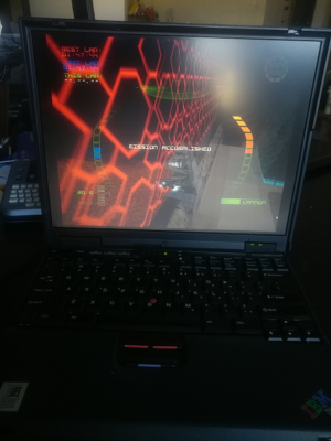

Era 4 (1997 to 2001):
3dfx forced many of the established video chipset players to shape up or ship out, and many did bow out (including Trident which crapped the bed with some horrific chips....and 3dfx after ATi and nVidia ate its lunch).
This era is immediately before the introduction of fixed function T&L and shaders on AGP. Audio-wise this is the twilight of old-school sound blaster/DOS compatibility, as many machines of the early to mid-era features both AC97 and a DOS compliant chipset for backwards compatibility (ESS Maestro 3 (no ESFM), Crystal Soundfusion, Yamaha DS-XG). OS is Win98SE to Win2K/XP, and CDROM is also replaced by CDRW and DVD-ROM.
Notable games from the era:
Half-life, Simcity 3000, X-Wing Alliance (the last of the Star Wars pure space sims - it uses an enhanced XvT engine that allows more options), Quake 3 Arena, Earth 2150, Incoming, G-Police, Shogo, Independence War
S3 SavageMX/IX/SuperSavage and ATi had the Rage Mobility M3/M4 (Rage 128 Mobility). Both are okay and performs near an nVidia TNT - so it’s competent for 3DMarks2000 but not for 3DMarks 2001 stuff.
Era 4 - (Coppermine PIII-500 to 1000MHz, USB 1.1)
Thinkpad A21p, A22m (Radeon M3), A22e (Savage IX8), T20-22 (S3 Savage IX8), all with CS4624 OPL3 hardware
Dell Inspiron 4000 /Latitude C600 - (Rage Mobility M3/128+Maestro 3e). You want to favor the Latitudes as they were fleet/corporate machines with a larger install base. Also, the C600 model has a 16MB Mobility M3 option which yields support for higher resolution gaming.
Toshiba Satellite 42x0CDT S3 Savage IX+Yamaha DS-XG - some with DVD drives)
Toshiba Portege 7220CTe
Sony Vaio SR17/27/33 (S3 Savage IX+Yamaha DS-XG)
HP Pavillion 53x0/Omnibook XE3-GC - S3 Savage IX+Maestro 3e)
Some of the SVGA based late era 2/early era 3 games might cause graphical glitches upon exiting VESA based DOS4GW games (Rowan flight sims or Microsoft Flight Sim 5). Other games like USNF might require Video BIOS shadowing to be turned off before they'll run (which is not an option on most machines)
Depending on the Soundblaster/OPL3 emulation used in the specific machines they might not sound right (some minor issues were found on the Crystal CS4624s). For Roland MT32 support you would want a PCMCIA gameport card or a docking station with a midi/joystick port (which the IBM T2x series and the Dell C-series will not support). NEC chipset based USB2 (FAT32 formatted USB2/3 thumbdrives) is also supported in Win98SE using a cardbus adapter - kludgey but do-able. Era 4 is really Era 3 but with an “okay” 3D chip onboard, but right before DOS compatible sound hardware got dropped thanks to AC97. Buy a Dell C/Dock II or IBM ThinkPad Dock II with full PCI support if you want PCI GPUs or better OPL3 support on actual cards.
These Era 4 machines are mostly compatible with Era 2, 3 and 4 gaming, and since they can run Era 1 games via DOSbox, they represent the apex of vintage gaming machines.
If you want better Era 4 performance but don’t care for DOS gaming, buy an early/mid era 5 machine (hardware T&L, early shaders) as they will be fluent running late era 4 games. You can also buy era 6 with Intel integrated GPUs.
