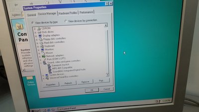

Reply 2 of 14, by dicky96
Thank you. I was looking for Windows 98 SE drivers
I've installed the chipset drivers and audio drivers from the links you posted.
All seemed to install to be OK but when I boot into windows I get a message to say the audio hardware i not responding correctly. If you click it three times then windows continues to load but I don't have any sound.
In the device manager the sound card seems to be installed OK. Possibly the driver link was not the right one?

Reply 3 of 14, by PC Hoarder Patrol
Saw a post on another forum of a user with same board but different OS - WIn 2K SP4. They tried the AD1881 drivers with same effect - SoundMax device manager entries but no sound. Someone suggested to try other sound codecs so having had no luck with ALC201, they tried Crystal 4299, and success! 😀

Reply 7 of 14, by Jed118
So I downloaded a file called INF2K that claims compatibility with 98 and when I go to the General tab (in 98's system properties) I get NTKERN.VXD, MMDEVLDR.VXD device loaders for this device could not load the device driver (code2)
It does see the device as the 82801BA/BAM controller though.
What's for sale? my eBay!
Reply 9 of 14, by Jed118
None of those drivers worked. After installing the SoundMax and the Cirrus ones Windows 98 kept autofinding them and installing those over anything else upon OS start / when I asked it to find more hardware. After a few ghost sessions (I have two of these systems, I had an image stored) to restore the baseline, and spending far too many hours on this, I threw a CT4810 at it, disabled the onboard sound (which worked fine in XP) and called it a day.
Strange, as this board came out in 2001 - I don't see why the OEM didn't provide Windows 98SE drivers, as the OS was only 2 years old at the time of the motherboard release. Maybe they did, but as of writing this in 2020, I can't find them.
Reply 10 of 14, by Jed118
OK so this is weird - I just picked up 4 more of these systems, same config as far as I can tell (it was almost a year ago to this date) and I had long repurposed the drive with the XP/Win98 partition, however, I took a copy off a random NEC Celeron machine that had XP/98 (guess what - XP had to be reinstalled 🤣) but whatever drivers were on Win 98 for the sound actually took! I mean, there's no FM synthesis, NSSI tells me it's the same card as in the computers I picked up last year, but the drivers loaded on the image outgoing the NEC are Vinyl AC'97 Codec Combo Driver (WDM)
