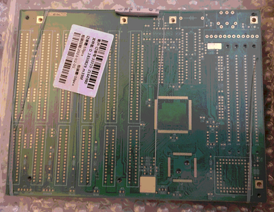

Hi guys, I have bought this board for cheap https://computer-retro.de/Bilder/Mainboards/P … miBios-1992.jpg . Because my 386 VLB is giving the error "RTC is not updating system halted" and it doesn't have DALLAS chip is an opti 895 ans SIS chipset
The M396F as a lot of corrosion under the battery that I removed. It has a broken trace that goes from the resistor near the keyboard plug that I already fixed.
I use a cheap chinese 4 digit diag card and it stops at 13.12, going to http://www.bioscentral.com/postcodes/amibios.htm it doesnt have the 13 code for motherboards after 1990, but before 1990 the error says "System-interrupt vectors initialized". The states are sequential? like after 13 comes 14 "8042 keyboard controller checks OK"? Could it be the keyboard controller bad? I already dessoldered the keyboard socket because it has green pins and need to buy another one to replace.
Can someone point me a way to repair this mobo? Mine is like in the photo but more corroded under the batt. And I cant see what traces are gone.

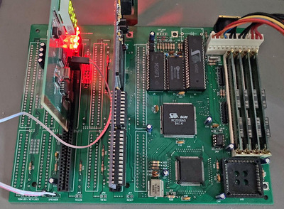

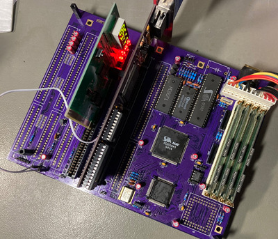

Hi Jorge,
i have exactly the same board. Mine is also badly damaged. That's why I decided to rebuild it. The first revision is already running quite well. But it still needs to be tested. If everything works you can repair your board with it.

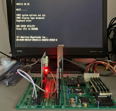

Reply 12 of 38, by EduBat
Nelson68k wrote on 2022-06-18, 08:25:
Rev 2 is ready and booting. Now test it thoroughly.
Absolutely incredible!!!
Out of curiosity, why did you do a revision 2? Was there anything not working properly with the previous one?

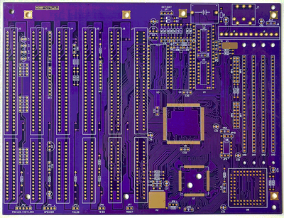

Reply 16 of 38, by Berzerkula
For anyone interested, I sent https://github.com/Marco-Both/M396F-Replika to the fab, and got 10 back. One for myself. If all is well, 9 will be available to dispatch. I want to build one to make sure all is well before I send the boards into the wild. There are parts available from the BOM for 10 builds, and I've received the parts and all look well. PCB's have ENIG and not HASL for surface treatment.
