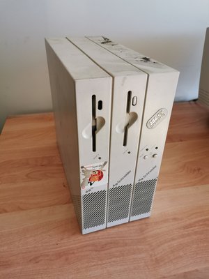

Earlier this year I got this beaten down Schneider PC that isn't powering on:
253.06 KiB
1002 views

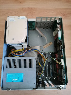

Opening it up revealed that it lacks one of the floppy drives and the hard disk is in the place where the missing floppy drive should have been:
342.92 KiB
1002 views

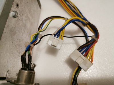

When I press the power button I can hear a "click" sound but nothing else happens. No fans, LEDs or any other kind of activity. It seems there's something wrong with the PSU, so I have taken it out of the PC and would like to investigate further, but I can't find a pinout of the proprietary connectors to try to manually turn it on and measure the output. This other thread has some pointers about the possible pinout but it's still not very clear. I'm pretty sure turning on the PSU involves shorting two of the pins, but I don't want to go around shorting random pins and risking making matters worse.
Does anyone have a pinout of these connectors?

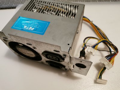

For reference here are some photos of the PSU:
207.75 KiB
1002 views
PSU
198.38 KiB
1002 views
PSU connectors
159.38 KiB
1002 views
PSU sticker
Reply 1 of 39, by devius
I've made this diagram based on the information provided in the thread linked above. I'll try to test this later today.

Reply 3 of 39, by Jo22
I second that. Fixing the PSU is definitely possible, but it takes a bit of patience (went through this myself once).
Also, check the diodes, that power mosfet and the voltage regulators..
Exchanging the diodes by stronger ones (1N4007 etc) also helped me.
Anyway, just saying..
PS: Oh, and replacing that old fixed disk by a flash card would also be a nice idea, even if it would be only temporary (during testing etc).
- These old monsters were really power hungry and could bring a weakened PSU down to its knees.
Edit: Sorry, I forgot. My Schneider BIOS didn't like CF cards. I had to use XTIDE Universal BIOS to make them work.
Reply 4 of 39, by devius
Ok, so from a first quick look inside I don't see anything obviously burned or blown up. I confirm that shorting the white pin to GND on the smaller connector leads to the relay being activated, but no power on the output connectors.
I don't think I have enough caps to replace them all today, so it'll have to wait until tomorrow. I'll continue investigating what voltages I get on the inside to try to figure out where the missing link is.

Reply 7 of 39, by Emu10k1
Something very similar happened to me in my 286 AT System 40. Ended up modifying a new Psu for it and has been working without issues so far for more than 3 years.
Schneider 80286 PSU?
Hope it can be useful. In the first post in that thread you can see the insides of the original psu, check if its similar to yours before doing anything.

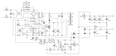

I've drawn a partial schematic of the PSU to help me figure out what the problem may be.
125.91 KiB
757 views
Schneider AT-VGA 386SX PSU Schematic (partial)
So, after a lot of time debugging I came across a burnt resistor. It wasn't immediately apparent that it was bad, but upon removing it from the circuit and measuring it it seemed to have failed open. It was R3 and it's necessary to power the controller chip when the PSU boots up. I replaced it but still not luck, although some voltages were indeed different, so I bought a replacement TDA4605 (the controller chip) and it sort of worked after replacing it, but the output voltage oscillated greatly between about 5V to 7V and it was the same value on both +5V and +12V rails which was weird.
After a lot of hours just going over the circuit trying to see what could have gone wrong, removing components, checking them and putting them back in I decided to try something radical and removed R21. Lo and behold it worked, as both the +5V and +12V rails were perfectly stable now 😮
I checked the -12V rail and it was also good, so all seemed good, but then I decided to check some more points and the Power Good signal is almost certainly not good. I measured 200mV, but according to ATX standards it should be 5V. I know this isn't an ATX PSU, but I bet the correct value should be the same.
Thinking it could be some kind of lack of driving capacity for the load imposed by R21 I tried replacing the original 8R2 resistor with a 18R one, but the result was exactly the same as before, so I left it out for now. I'm pretty sure this can't be the correct fix.
My findings so far lead me to believe the culprit is the Power Good module, which I have been ignoring until now, so I'll focus on that next and hopefully get to the bottom of this.

Reply 12 of 39, by derSammler
You are talking about a PSU from 1988! Nothing even close to ATX.
Power_Good controls the reset logic of the mainboard. When the PSU is working correctly, it should trigger the reset logic. Haven't checked myself, but it should turn from High to Low (or vice versa) shortly after the PSU is switched on.
btw, the schematics of the PSU are available.
