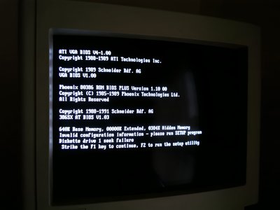

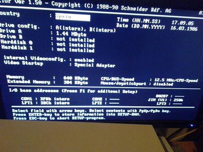

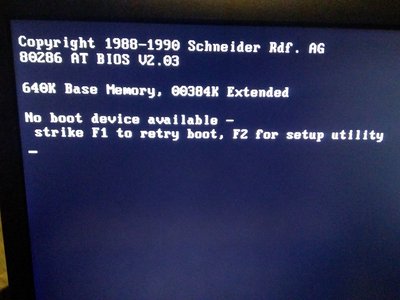

Sorry for being late. Had to take care of some things yesterday and i could not take the 286 for a ride.
It was actually F2 the key i was pressing to go into setup and not Supr (del). I´ve attached two shots of the bios version and the options i can choose in it. Im not using a Hard disk right now, had some problems with the one i was using and Ontrack disk manager... i should take some free time out of work and actually test an IDE to CF in this machine.
Really hope you find this useful.
Keep going! Regards!.

However now I can't for the life of me get into the BIOS setup again. I tried F1, F2, F10, Del, Enter, Ctrl and so far nothing. What I do is tapping the key repeatedly after pressing the Reset switch until it starts beeping. It never works. Always counts the RAM and boots straight to DOS as if nothing happened.
Previously when the battery was dead it would not save the settings if I powered down the PC, so it presented the option of pressing F2 to enter the setup on the next boot, but now I can't count on that any more.
Can anyone explain what is the exact procedure to get into the BIOS Setup?

Ok, I was able to get into the BIOS setup by removing the floppy drive cable since it was configured to also halt on floppy errors. I enabled stopping on keyboard errors, so now I'm able to get into the setup by using the trick of holding down the Shift key. I would still like to know how to do it normally though.
The battery is soldered down, so it would have been a pain to remove it.

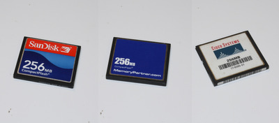

87.07 KiB
181 views
I ordered 3 cards but only the Cisco one worked properly. The others would always hang at 98% when installing DOS 5.0, and even installing on a VM and using dd to write the raw image to the cards wasn't working. I could see the files and boot fine from a floppy disk, but when trying to boot from the card it always complained that the disk was not bootable.

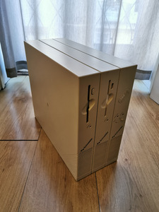

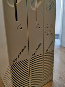

746.85 KiB
181 views
608.42 KiB
181 views

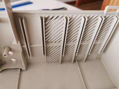

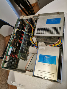

It has a few scrape marks, but they're clean now so not as noticeable. And the insides:
947.37 KiB
181 views
1014.25 KiB
181 views
I'm very happy with the result! The PC works and looks great now. 😃
