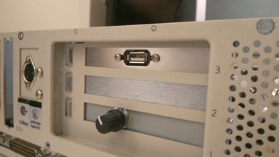

Reply 46 of 59, by brostenen
USB-Keyboard port is now in place..... (more info on the blog)

Reply 47 of 59, by henryVK
Bro, I only just got around to reading some of your blog posts on this, but I couldn't figure out what that potentiometer sticking out the slot bracket is! So, forgive my ignorance: what does it do?
Really like where you went with this stealth build.
Oh, and, as a fellow sufferer from depression: WAY to hang in there and keep your head above water. I sincerely wish you all the best.
Reply 48 of 59, by brostenen
It is the selector, for the Kickstart switcher. (the one that allows me to use 4 kickstarts) A lot of people want such a thing, to be keyboard operated. I am more the type that want it manually operated. And thanks. I like that you find it interresting. 😀 I know that I am writing a ton of text, yet I like to do it this way, compared to all them YouTube videoes out there. Just want to do things a bit different in my life. 😁
