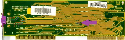

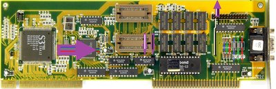

@Doornkaat, thank you for those pics! At last i got back to this thing now...
All looks good with multimeter.
At the same time, on second picture, near the D-SUB connector, there are 6 diodes right? Should they give a beep as well with multimeter? Right now, on both directions, with bottom 3 diodes i get ~70 ohms, and on top diodes i get overload both directions. (Testing with the beep mode of multimeter)
Is that normal? What should i see on those diodes?

Reply 14 of 22, by maxtherabbit
they should be diodes yes, specifically protection diodes
the top three should be oriented with the anode toward ground and the cathode toward the DAC color outputs - this protects the DAC from a negative potential being applied to the color lines from an external source by allowing (conventional) current to flow from ground to R, G, B
bottom three *should* be doing the inverse, anode toward R, G, B cathode toward +5 to protect the DAC from positive potential. I can't see anything connected to the southern vias of the bottom diodes to confirm this though.
you should be able to remove all 6 of them and still use the output for testing purposes

Reply 19 of 22, by Tiido
Those are standard 1N4148 type things. Any high-speed signal diode will do and you can even get away by not having any at all, especially for testing. Remove them and if the problem presists you know the RAMDAC or its support components have a problem instead.
