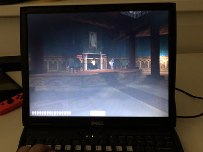

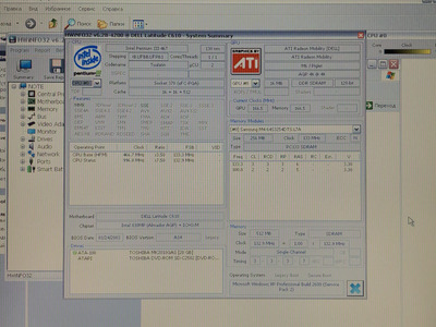

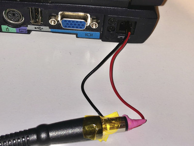

Thanks ragefury32! Just received this laptop, but no charger was with it. Since I’m terribly impatient person I’ve made up my own charger from another Dell adapter:
1.02 MiB
1843 views
And yes, it’s M6 and Thief II, Deus Ex, Unreal works just fine.

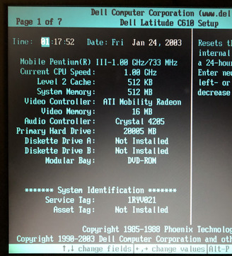

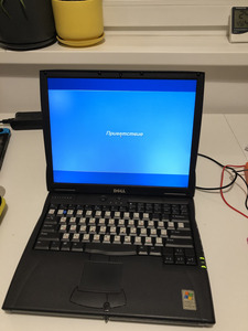

Next thing is to get this sound chip working under native DOS.

Reply 123 of 890, by ragefury32
vorob wrote on 2020-07-02, 06:22:
Not going to happen - The Crystal CS4205 is AC97 only. The last Dell C-series with DOS sound support is the C600/Inspiron 4000 and the C810/Inspiron 8100.

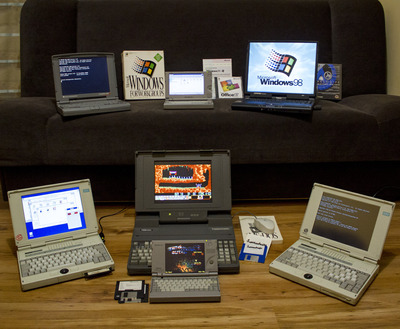

Here is my old post with good laptops Old laptops 386, 486, P1, P3 - all with DOS audio and good specs - TFT screens, floppy drives, sound cards. 386 to Pentium 3.
I think that that the laptop with best compatibility ever is Compaq Presario 1800 😀 (upper right on the photo) model number 18XL481 - be sure to look for that one or check the specs
MS-DOS to Windows XP compatibility
* Floppy drive
* CD/DVD drive
* TFT 1024x768 screen with -smooth scaling-
* DOS compatible ESS Solo 1 sound card (with good quality FM music, unlike ESS Maestro; you just need to load DOS driver)
* Very good JBL speakers (there is some noticeable bass and stereo width)
* Pentium 3 700 MHz
* 3D acceleration: Ati Rage 128 8MB, games like Half-life work flawlessly
* PCMCIA/Cardbus (Orinoco wifi in DOS or modern cardbus wifi card in 9x/XP)
* SVGA driver works in Windows 3.11
* Gameport if you can find a docking station
* ethernet, modem, USB, PS/2, VGA, COM, LPT, TV out
Videos:
DOS audio https://drive.google.com/file/d/0B2rbHIj6SMlF … zVjQXQ0bFk/view
GTA 3 😀 (with some hack to run on 8MB VRAM) https://drive.google.com/file/d/0B2rbHIj6SMlF … V9ieWdYbXc/view
I have multi-boot with MS-DOS, Windows 3.11, Windows 9x, Windows XP, Linux and everything works great. Didn't use it in quite a while, but turned it on now and it still works.
