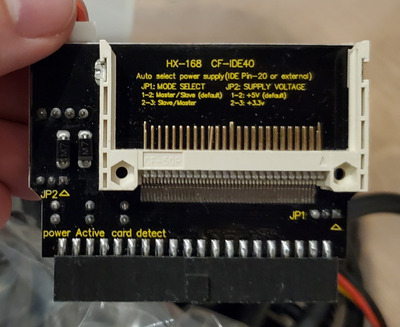

Reply 1024 of 1061, by Kahenraz
Here is more information for the problematic adapter I used. I bought a couple of them at the time and they all exhibited the same behavior, so it wasn't as simple as a single bad unit.
Why does this CompactFlash to IDE adapter behave differently?
Reply 1025 of 1061, by primetime
Yeap, I've concluded that none of these adapters are really fit for use as they are - if you get one working with little to no issues then that's great it's lucky. Most are cheaply made and who knows with little to no quality control and also cutting costs thru components etc. The other issues with these CF adapters is that they do not cater for 3.3V or 5V voltage selections - simply that they have no proper voltage regulators at all. My friend soldered voltage regulators on his adapter so that it's properly supplying 3.3V whenever he uses his CF-SD converter. These adapters in most cases uses only diodes to step down the voltages which is cheap and nasty way to do so. For that fact even proper CF cards really needs 3.3V even though the standard says they "should" work with both voltages! But we're digressing, I've got output files ready for 640k!Enough - just need to know how to get it across to him.

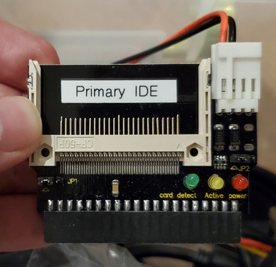

Reply 1031 of 1061, by Kahenraz
primetime wrote on 2023-09-25, 00:12:
Thanks Darry, I wasn't aware that there was a CF-IDE adapter with a proper voltage regulator I'll have a look. 640K!enough here are the two files.
Here are photos of one of my CF-IDE adapters with a voltage selector.
442.63 KiB
1501 views
510.84 KiB
1501 views
