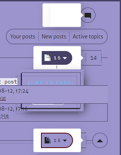

Reply 107 of 112, by breech
Sorry if this has been mentioned already, for the C64 purple theme which I quite like, navigating thread pages can be quite difficult and the styling around the controls is somewhat broken.
  • Depth of items is incorrect
  • White areas block controls
  • Page numbers cannot be easily navigated to
  • Text in certain controls (such as jump to page and some page numbers) is difficult to see
  • No search option is available so requires URL manipulation
26.05 KiB
1419 views
Reply 108 of 112, by cyclone3d
What do you mean there is no search option? It should be just to the left of the notifications icon.
What browser are you using?
All those little snips you have there show completely different for me.

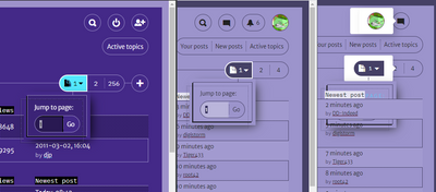

Reply 109 of 112, by breech
Thanks, you clued me on to what was happening. Comparing incog mode, canary and normal chrome I found the Decentraleyes privacy extention was messing with the layout. Toggling it off/on sorted it out. They weren't snips, that's how messed up it was 😁
103.2 KiB
1392 views
