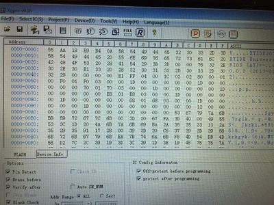

Reply 29 of 80, by BlackLinus24
Sorry for the delay.
So, I've come around trying to do the steps you recommended. I think I'm a bit at a loss here. So, the 512 kb EEPROM chips I had did not work with the NIS. I ordered 64 kb ones and they now work, but I don't know who to write the BIN file to the particular address as indicated in the NIS setup tool.
So programming the chip with the ATL.BIN file does not work as the BIOS seems to be located an address where the NIS is not looking for it. Any advice?
I assume these are fundamentals for savvy IT guys but I'm at a loss regarding these addresses. I can't find the ones indicated in the NIS Setup tool in the EEPROM programmer tool when reading the EEPROM chip. Copy and paste also did not work as there are no addresses beyond the ones in which the content of the ATL.BIN file have been written to. At least that is my interpretation of what happened.
Again, many thanks for your help. Hope there is only a small step ahead to finally getting the 386 machine to work.

Reply 30 of 80, by Predator99
Looks very good. Try to program this image to your EPROM.
Size to be configure on the 3COM is only 8 kb.
    xt-idext.rar
    5.62 KiB
    7 downloads

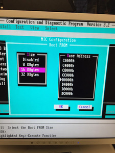

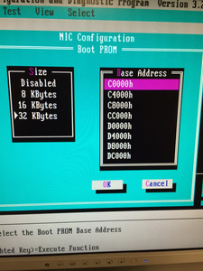

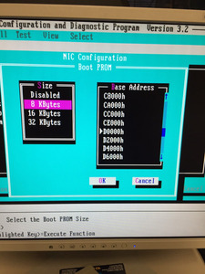

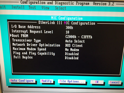

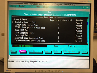

Reply 32 of 80, by BlackLinus24
I did exactly what you suggested.
When I choose the first address from the 8kb address list the setup program says that I did not recognize the EEPROM. On the second address (screenshot) the whole program froze and I couldn't save or do anything. All the subsequent addresses worked (to illustrate I attached a screenshot of one of the tests - which I did for each address that actually I was able to saved to the NIC).
However, after booting the computer no matter what subsequent address from the 8kb list I chose in the NIC setup tool (and successfully saved to the NIC), the XT-IDE Bios would never post, never. Absolutely nothing.
Any clue what to do now?

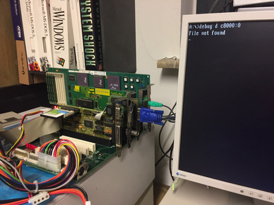

Reply 34 of 80, by BlackLinus24
Predator99 wrote on 2020-01-21, 10:05:
Put Dos debug.EXE on your Boot Disk Type...: Debug D C200:0 […]
Type...:
Debug
D C200:0
It should Display the content of the ROM if adress c200 is selected. What is the output?
Just for me to understand. Does the D C200:0 refer to C2000h - C3FFFh which I could not save to the NIC? If so, what is the purpose of it since this is the only address range that I could not select and save.

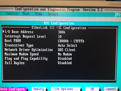

Reply 35 of 80, by Predator99
Your Screenshot above says the ROM is currently located at Memory starting adress C200:0 and ends at C3FF:0. Thats the perspective of the NIC and seems to be OK.
But it does not work.
Thereofre I like to look what your 80386 sees. Thats what debug.exe can show you. With the command "D C200:0" its shows you what data is located at memory adress C200:0. D means dump.
So in theory you should see some strings indicating your XT-IDE ROM is there. If not, its no surprise its not executed on startup.
Reply 36 of 80, by BlackLinus24
Predator99 wrote on 2020-01-21, 16:39:
Your Screenshot above says the ROM is currently located at Memory starting adress C200:0 and ends at C3FF:0. Thats the perspecti […]
Ok. I see that my previous post with the screenshots was a bit misleading. Actually, with the first screen shot I wanted to show the address range which when choosing makes the NIC setup tool freeze. Thus, this is actually the only address range I cannot save to the NIC. When choosing the address range before that the program complains. All other address ranges from the 8kb list work. I can save them to the NIC. Also, each of those address ranges seems to pass the tests (as illustration I sent you a screenshot). Sorry, my mistake. I realized that when seeing both screenshot you though that the successful test was linked to the first screen shot with the address range C200:0 to C3FF:0. It's not.

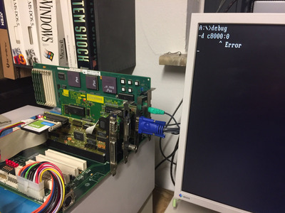

Reply 39 of 80, by BlackLinus24
Predator99 wrote on 2020-01-22, 09:40:
Makes no diffence...then follow the procedure with a working adress. If its D000 type
Debug
D D000:0
Ok. That operation was not successful. Or maybe I missed something?
I tried it with one of the addresses which the NIC setup tool accepted and which I could save. Quite frustrating.
It seemed like such an easy thing to do. Program the XT-IDE to an EEPROM put it into a NIC and on we go.
What to do now?
