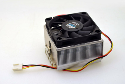

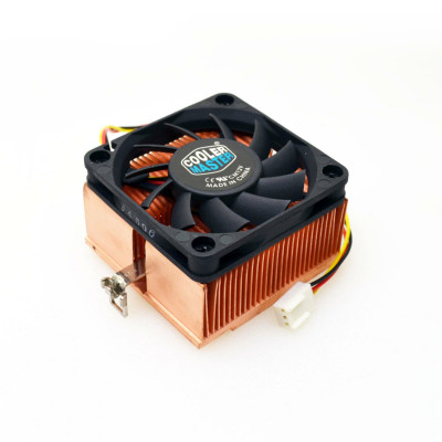

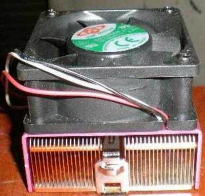

Reply 8 of 21, by cyclone3d
Thin fin heatsinks are going to be really good. A heavy hunk of metal with thick fins will not cool very well.
Any of these should work just fine.
131.23 KiB

Cooler Master 2U 60x38mm Socket A 370 CPU 3-Pin Cooling Fan with Copper Heatsink
108.91 KiB
2243 views
Cooler Master Socket 370 Cooling Fan MicroFin Heat Sink
242.99 KiB
2243 views
Pentium 3 III Celeron Copper Core CPU Cooler Heatsink Fan Socket 370 VIA C3

cyclone3d wrote on 2020-01-13, 15:35:
That copper Cooler Master looks appealing, bad thing that it's nowhere to find in Europe.
Would this Akasa heatsink count as "hunk of metal"? 😁

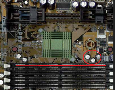

Reply 14 of 21, by PC Hoarder Patrol
Although the larger-style 60 to 80mm sloped heatsinks, like the Titan listed by @Zoomer, will fit the MSI-6905 V2 slotket (I've checked with my own ones) and there is clearance to the motherboard surface (of about 7mm) which should just avoid the chipset heatsink, the problem is the caps next to the nearest ram slot and the first slot itself. Because the socket on the MSI is offset nearer to the motherboard edge, the marked areas will likely snag the bigger coolers so I'd avoid these and stick to any good 60mm ones listed that you can get hold of. Also, I'd avoid that Akasa you listed - the heatsink is OK but in combination with the fan it's noisy (I swapped the fan for an 80mm one on a 60 to 80 fan adapter. Note that the one linked by @lost77 is only 50mm.

PC Hoarder Patrol wrote on 2020-01-13, 21:16:
Thanks for those little details, much obliged.
