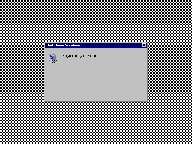

Reply 25 of 39, by theelf
6.31 KiB
344 views
shut
I success!!!! one of the last things i did not make was the shutdown dialog! finally discover how to do 2 things:
1 - Avoid the fade off and replace with checkers pattern
2 - Change the menu to match 95 one
Not only this, as a bonus.. the "Restart computer in DOS mode" what does is close explorer... and open a fullscreen DOSbox jeje
The trick was difficult as hell, if someone know a better way... PLEASE i really want to know
The first is to change resource in explorer, in the menu, change the sutdown to another option we dont use, in my case "disconnect"
then edit the "disconnect "resource in shell32.dll, and change the dialog to draw "out" of screen, for example start at 5000px from left
then write a autohotkey script that wait for the pid #32772 that is the shutdown dialog, intercept the "disconnect" dialog, close, and open the shutdown dialog we want... in my case i write in same autohotkey

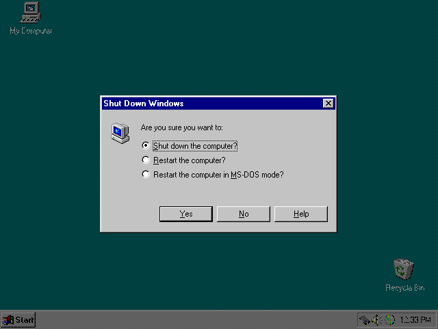

looking4awayout wrote on 2020-01-23, 19:58:
Why not sharing the AHK scripts you are making? I use AHK as I have an 84 keys AT keyboard and some games don't detect the numpad as arrow keys. As I am absolutely ignorant about how AHK scripts work, I think it wouldn't be a bad idea to share them here.
By the way: how in the world did you remove the fade to grey effect and replace it with the dithered background? I'm amazed.
Hi, for example, the shutdown dialog, i resolve with a autohotkey script with this code
If you copy/paste in a ahk file, and put the png in same folder, you can test
SplashImageGUI(SplashImage, "0", "0", false, true)
gui, +AlwaysOnTop
gui, -Caption ;
gui, +ToolWindow
gui, +owner
gui, show,w280 h130 x200 y200
gui, add, radio, checked1 gapaga1,&Shut down the computer?
gui, add, radio, greset1,&Restart the computer?
gui, add, radio, gdos1,Restart the computer in &MS-DOS mode?
Gui, Add, Button, Default w79 x34 y107 gyes1, &Yes
Gui, Add, Button, w79 x117 y107 gno1, &No
Gui, Add, Button, w79 x200 y107 ghlp1, &Help
return
apaga1:
return
reset1:
return
dos1:
return
yes1:
return
no1:
return
hlp1:
return
SplashImageGUI(Picture, X, Y, Duration, Transparent = false)
Gui, XPT99:Margin , 0, 0
Gui, XPT99:Add, Picture,, %Picture%
Gui, XPT99:Color, ECE9D8
Gui, XPT99:+LastFound -Caption +AlwaysOnTop +ToolWindow -Border
If Transparent
Winset, TransColor, ECE9D8
Gui, XPT99:Show, x%X% y%Y% NoActivate
