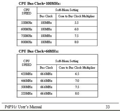

Reply 21 of 32, by PARKE
It is always a pity to have to give up. But I am not so sure about the maximum 700 Mhz limit. What is the sSpec number on the 600E ?
The manual states this:

Reply 28 of 32, by red_avatar
PARKE wrote on 2020-01-30, 01:18:
The manual states this:freetech.JPG
SL43E
And nice - the sheet I found stated 700Mhz as the max.

Reply 30 of 32, by PARKE
red_avatar wrote on 2020-01-30, 18:57:
SL43E
Your 600E cpu has CPUID 0683h and the Bios of your motherboard obviously contains the microcode for that stepping.
A relatively safe bet for the sort of modest upgrade you are looking for would be this cpu: Intel Pentium III SL4BZ CPU Processor 750MHz 256KB 100MHz
This is the fastest cpu with that same cB0 stepping, it came out on October 25, 1999.
The 800 Mhz SECC came out on December 20, 1999 and has CPUID 0686h.
