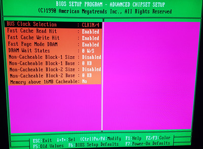

I did build my 386 system yesterday Early 90s 386 build as close to period correct as possible.
It has 128Kb of 20ns cache. The motherboard also has room for another 4 cache chips. I can run the system well with 0WS in bios. Would that likely change if I bought more same 20ns cache chips and added them there? Would I need to do anything about the tag chip? Would 256Kb cache matter when no more than 8Mb of ram?
Is there even any info online on what jumpers I would need to change if I added more cache?
1.26 MiB
201 views
Fast cache read hit, fast cache write hit and Fast page more dram were disabled by default in bios and I changed them to enabled even though I am not sure what they do exactly.

Baoran wrote on 2020-02-04, 02:28:
This specific version of the BIOS is very limited in options, I see no options to set the cache read/write WS, just for the RAM.
Reply 35 of 42, by Anonymous Coward
Some 386 chipsets do not support 256kb cache even if they have sockets to accept it.
I think the Octek Jaguar IV is a good example of this. It has two banks of cache sockets and can accept 32kx8 SRAMs, but 128kb (in a single bank of four 32kx8 chips) is the max supported by the Headland chipset that the board uses.
It's best to check the chipset manual (if you can find it) and/or your motherboard manual before wasting your time. Generally speaking, if your 386 board uses a 486 chipset there is a good chance it can take 256kb as long as it has enough sockets.
Reply 36 of 42, by Baoran
Anonymous Coward wrote on 2020-02-04, 08:32:
I assume it uses 486 chipset because some version of the motherboard have bigger socket that accepts 486 cpu where the 387 socket is on mine FX-3000 motherboard thread
Those versions also have more options in the bios. I have not been able to find manual for it online though, so I don't know what jumpers I would have to change if I installed more cache
Reply 37 of 42, by konc
Baoran wrote on 2020-02-04, 09:07:
I believe it's easy, the link to Phil's thread you just posted has the motherboard full of cache and you can see the configuration of W2-W9 jumpers. That should be enough 😉
