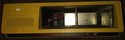

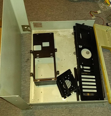

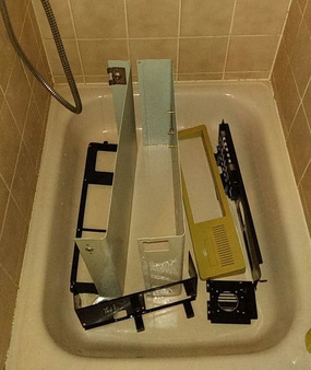

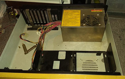

i`m going to build a Turbo XT System with parts is got from various Sources 😀
Part 1: The Case
i got this one for free from the User 6502 from DosReloaded:.

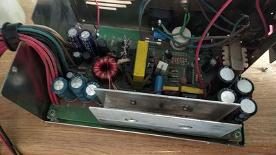

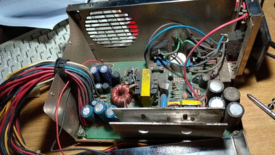

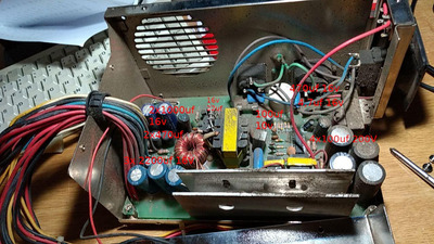

Part 2: The Power Supply
A Quick Test was running and i measured 5V and 12V, then the FI switch kicked in.
So i opened the PS and got a Surprise:
173.17 KiB
393 views
84.67 KiB
393 views
78.46 KiB
393 views
69.72 KiB
393 views
Glueing some FR4 under the Broken PCB with Epoxy:
63.78 KiB
393 views
Now it`s time to let everything dry 😁

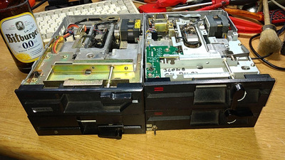

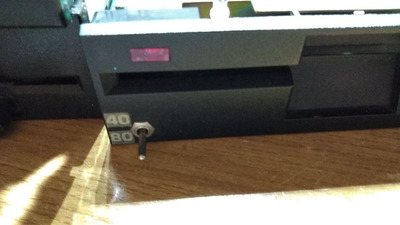

Part 3: The Drives
5,25" Drives (still untested)
Co2 - for a endless Summer

PCB repaired:
Epoxy and a quadratic FR4 piece make it as stable as new, drilled a new hole and now we ready to reattach it:

Caps for A-Matic Switching Power Supply:

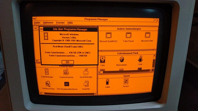

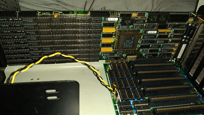

Part 4: Mainboard
197.24 KiB
307 views
Board installed 😀

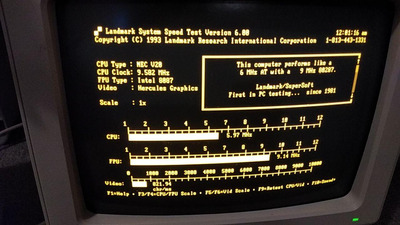

A Unknown XT Board with Faraday Clone Chipset running the XT up to 9.54Mhz Speed.
I had real Fun finding a BIOS that works.
The Capacitors near PowerSupply are exchanged, there now 10uf Capacitors with 100nf X7R on the underside.
Turbo XT BIOS does only support 512Kb RAM on this Mainboard.
It does not enable the 128Kb Bank, sad..
So i sourced a BIOS from 1986! which works fine.
But is incombatible with VGA, it always shows Video Memory Bad if a VGA Card is inserted.
It also allows to Switch Speed with CTRL + Alt + "+", Default 4,77Mhz, 7,68Mhz and Turbo 9,54Mhz.
i would prefer booting at 9.54Mhz. But with this BIOS its not happen 😀
A Intel Above Board supplies another whopping 1,5Mbytes of EMS.
180.36 KiB
303 views
from time to time i find some 41256 so i filled 3 Banks of Memory in few months.

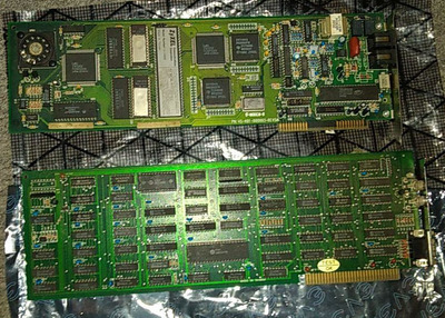

Part 5: Expansionscards

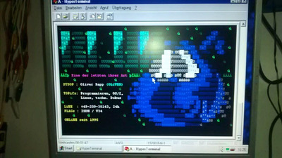

I have a CGA Clone Card, but no Screen.. that sucks a a bit, as my Monitor is HGC only.
236.75 KiB
290 views
The other Card is a Fullsize Zyxel Modem and fully Operating, i already tested it 😀
109.76 KiB
290 views

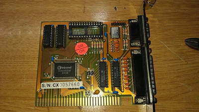

For now i have to use a 16BIT Multi I/O Controller as Floppy Controller and a XTIDE CF Card, as i have no Period Correct Controllers yet.
The Videocard i will use until i get a nice Colour CGA Screen 😉
195.03 KiB
283 views

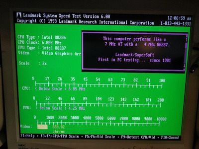

This is my XT:
114.58 KiB
231 views
GPL-2.0-or-later
And IBM AT 286 6Mhz / 287 4Mhz:
175.08 KiB
231 views
GPL-2.0-or-later
Tested Drives today and found 2 working 5,25" 😀 i`m glad they work!.
