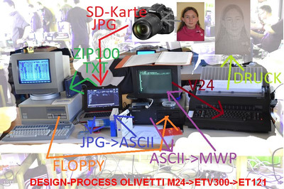

103.23 KiB
284 views
How to print a portrait on a typewriter?

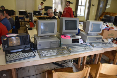

81.97 KiB
284 views
My exibition at Heinz Nixdorf Forum, Paderborn, 3/2019

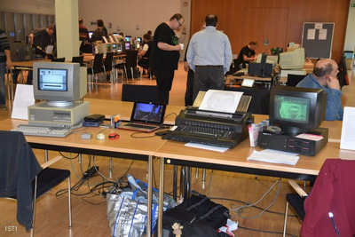

80.87 KiB
284 views
The M21&24&24SP&240 armada...
