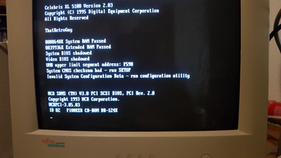

Has anyone here had a similar problem and figured out how to have the computer be possible to show video again?
if i wait for a while after, the floppy drive lights up and the computer does a bleep, bleep, code if waiting long enough.

That beep is certainly weird, assuming it uses a Phoenix bios I can't say if it's 2-1-1 or 3-1-1. Are RAM and video card known to be good?
Nic-93 wrote on 2020-02-07, 20:06:
Oh, yeah, should possibly add that the disk drive keeps making that seek noise as if waiting for a disk to be inserted but once i do, it does noting and the beeping stops.
It may be looking for a crisis disk to recover a corrupted bios.

I did some small modifications like adding in a hard disk with 131 megabyte of space and gave it more SIMM ram around 40 meg, the video card and rest is stock, no change to it.
is it even possible to download the crisis disk?
Reply 6 of 25, by Nic-93
Found the model-specific disk and placed it on my disk emulator and was asking for it and seemed to read fine, gives out this error code after its been reading the disk for a little, then reset's.

Reply 8 of 25, by Horun
You need the NCR SDMS scsi driver package for the onboard scsi adapter. Not sure which version would apply to your board but would assume version either 3.x or 4.x . You need to look at the scsi BIOS version during boot and see what number it is. If it is NCR Bios 3.x. then you need v3.
v3: http://vogonsdrivers.com/getfile.php?fileid=405&menustate=0
If by chance it is NCR or Symbios Logic Bios v4 then you can still use SDMS v3 but SDMS v4 would be better. You cannot use V4 SDMS with a V3 BIOS..
Reply 9 of 25, by Nic-93
As far i know its version 3 of the bios, this is all the info from the bios boot am given.
did remember to take a bios picture of the version number.
would i need to add them in a specific way/order?
Reply 10 of 25, by Horun
Yes that is v3 bios. Are you trying to make a boot disk that has cdrom support ?
