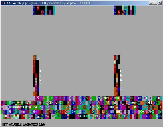

Reply 5 of 11, by slong
The AP is named ET-Chinese system V3 of ETEN Corp.Taiwan.
It is used to display double byte character set(DBCS) in Chinese, by access the ROM addrress directly, by TSR, I think!
But the company is not maintain this AP now!
When I run this AP on DOSBox, the Screen(or Window) become unreadable, and many unnormal color block display, prompt string become unreadable too.
Respone character was very strange, not corrected, keyboard keyin.
I had been run this AP successful by VMware 3 DOS client on Windows 2000/XP host, on friend's computer.
    29.93 KiB
    1342 views
    Screen snapshot
Reply 6 of 11, by mirekluza
Rank DOSBox Moderator
DOSBox Moderator
Well, it would be probably necessary to debug the program to know what is wrong. I doubt that developers have ever heard about it and also that they would be very interested in fixing it (it is a rather obscure thing, probably not used by many people).
Saying that, I am certain that if somebody looks into it and finds a problem, they will gladly accept a solution into DOSBOX. DOSBOX has its intternal debugger which could be usefull (PRIESTLYBOY makes debugger enabled builds on his forum or you can compile yourselves).
Mirek

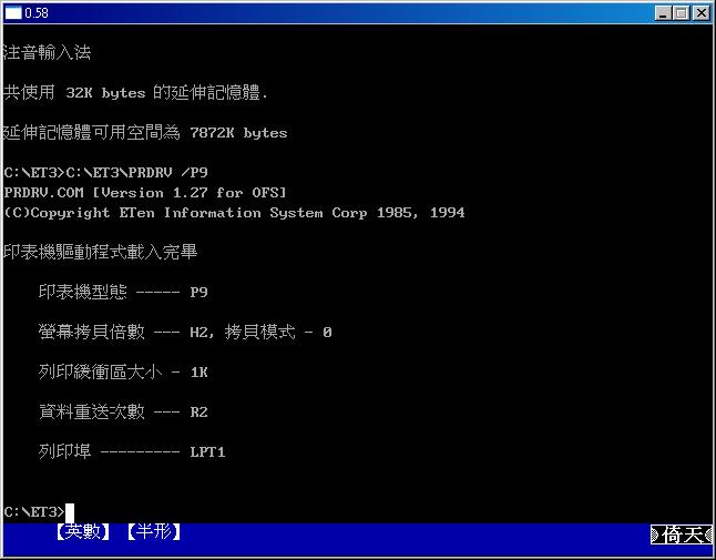

Reply 9 of 11, by Qbix
Rank DOSBox Author
DOSBox Author
hmm some link to freeware program ? or a complete name of an application. as if it worked in 0.58 then we might be able to find out why it fails in 0.63
