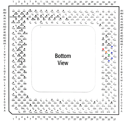

Reply 9 of 15, by Doornkaat
Robin4 wrote on 2020-02-22, 22:04:
If the board would getting running an pentium 133 or 150 mhz id really would be happy.
Ok, so what you want to do for 2x multiplier is pull BF0 (pin Y33) low, i.e. connect it to ground/Vss. This can be done on the CPU as well as on the socket at the backside of the board.
Remember that until removed this mod permanently sets a 2x multiplier on all CPUs that accept it.
You can also set a 2.5x multi (BF0-Vss and BF1-Vss) or 3x multi (only BF1-Vss). Using BF2 will probably not get you anywere because CPUs supporting it won't fit into Socket 5 iirc. Depending on your board's VRM you may get instabilities with faster CPUs though I doubt you'll have any problems with 133 or 150MHz Pentiums.
I have attatched a pinout with the relevant pins marked; red is BF0/Y33, orange is BF1/X34 and green is BF2/W35. Connecting those with any of the pins marked blue will have the same effect as setting the corresponding jumper. As stated in the picture it shows the bottom view i.e. the side you're probably going to be working on - the backside of the board or the pins of the CPU. This makes things much easier. 😉
Even though this is a pretty straightforward process and an easy mod of course things can go wrong and I don't take any responsibility for damages. You do this at your own risk.
Have fun and good luck! 😀

Reply 11 of 15, by Doornkaat
Robin4 wrote on 2020-02-25, 00:33:
Thanks for the help.. But what does BF pin stands for? Iam guessing its a abbreviation?
BF pin means one of the pins used to control the BF signal that is sampled upon reset telling the processor what multiplier to use. I also think it's an abbreviation but I'm not sure what it stands for.

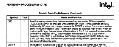

Reply 14 of 15, by mpe
From 1995 book "Pentium Processors and Related Products" by Intel:
