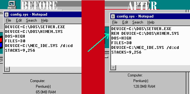

As pointed out many times before in this thread, the problem lies in the old HIMEM.SYS loaded and has nothing to do with the alleged service packs. Win98's well known ram bug's more for >512MB and the "service packs" won't fix that either.
The only possible scenario I can imagine this occuring is if Win95/98 were performed as an 'upgrade' over an existing Win3.1 installation with DOS 6 on it prior and somehow the old CONFIG.DOS copied over the CONFIG.SYS. This would've never happened on a fresh formatted Win9x install.
Here's how to fix the "bug" in Windows 95:
    5.01 KiB
    503 views
