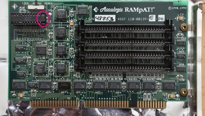

I have difficulties getting my Acculogic RAMpAT! running.
1.53 MiB
469 views

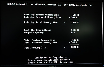

I have downloaded the driver disk and boot from the disk image. All I get is the following screen:
520.24 KiB
469 views
There is no card-RAM detected. It doesent matter at all if the card is installed or not..! If have tried several known working Simms but no change.
What is wrong? Is this caused by the empty Dallas DS1292? Or is the fault somewhere else.
So it would be nice to know if somebody has such card running? The battery should be empty in all cards in the mean time? Or do I have to start somewhere else...?
Thank you! 😀

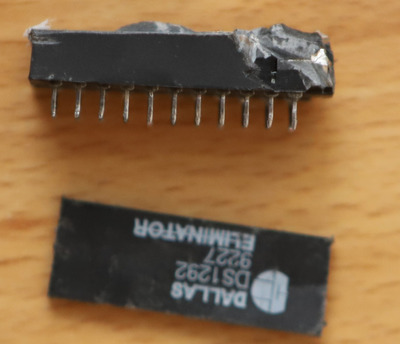

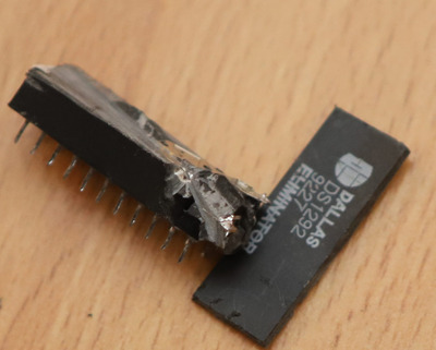

Reply 4 of 27, by Predator99

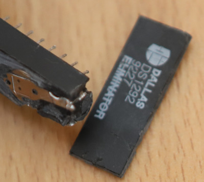

So I "eliminated" the Dallas Eliminator 😉
When comparing to the datasheet the Pins 1+24 are missing on the Dallas. I assume these are bent to the top and the battery is connected there? Does it makes sense to start at this location to look for the battery?
Unfortunately there is not much to find about DS1292 or fixing its battery...
1.52 MiB
405 views
Reply 5 of 27, by Tiido
Yeah, battery is most probably right there and I would start grinding it open at that end, it shouldn't take a lot of effort to get access to the battery terminals. You will probably need to grind enough to identify the postive or negative terminal to be sure things are correct since reverse connection often causes damage.

Reply 8 of 27, by Predator99
Thanks for your replies!
I already attached the datasheet under my initial post, thanks for searching again anyway 😉 Its confusing as in the datasheet the DS1292 has 24 pins. But my specimen has only 22 pins.
I understand both the 1292 and the 1293 have 24 pins according to the datasheet.
Picture: Look again 😉 The IC with the circle is the desoldered DS1292 with pins showing up 😁

Reply 11 of 27, by Predator99
I have to admit not the nicest work I did here 🙁
I was right the baterry is connected to Pins 1+24. But there was no Charge left at all so I had to dig further to see where is + and -.
The battery is not labeled but I assume its (+) on the top and 3V....
I really like these Dallas Chips....

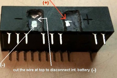

Reply 12 of 27, by Horun
Good cut job ! On all the Dallas I frankensteined, the battery - is also grounded and they are 3v. Using a good DVM measure Ohms from pin 12 (chip GND) to the battery and you should be able to verify which part of the batt is the - side.

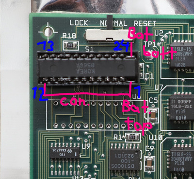

Reply 13 of 27, by Predator99
Wait...chip ground is (-) ?
I assumed the top side of the battery is (+). But the top side of the battery is connected to Pin 1. And there is a connection between Pin 1 and Pin 12 (GND).
That mean the top side of the Battery is the (-) side..?!
489.78 KiB
285 views

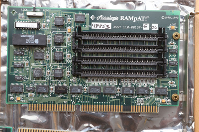

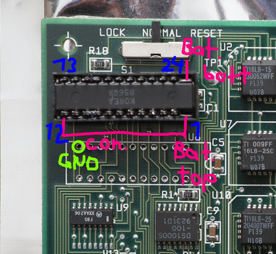

Reply 14 of 27, by Predator99
I also verified Pin 12 (GND) assigment is correct as the corresponding mounting hole is connected to ISA-GND (green).
495.69 KiB
285 views
Battery top connects to Pin 1:

Reply 15 of 27, by Horun
Predator99 wrote on 2020-03-08, 15:22:
Yes ! Just like the DS1287, the batt - is on top and does go to ground, like in this picture
