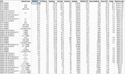

Here's a complete breakdown of slowdown options for my 486 DX2/66 and Pentium 200MMX. This should give you an idea of what your systems might be capable of. Although, each 486 motherboard's Turbo performance is a bit different, so your mileage may vary.
113.87 KiB
201 views

clueless1 wrote on 2020-03-22, 19:32:
Is there a legend for what all those acronyms stand for? DCD, VPD, L1D, etc.? Is that terminology from SetMul or like industry-standard acronyms I should learn?
I'm unable to get my 200 MMX down to any of your numbers below 17 – numbers where it says L1D, L1D+BPD, L1D+BPD+VPD. So it very well could be because of my MB doesn't have those Cache options or whatnot (seems to only have External and Internal and that's it).
Reply 11 of 12, by clueless1
Dochartaigh wrote on 2020-03-22, 20:33:
It's all in the setmul documentation. L1D is L1 cache disable (could be done either through the BIOS or with setmul). The "test register" TR12 options are available on MMX cpus only. If you haven't tried them on your MMX, give 'em a shot. Quoted the relevant parts below:
PARAMETERS /? - default help screen. [Multiplier] - as a single digit like '5', or '5.0', or halves like '5.5'. L1D - L1 Cache D […]
My MMX system does not have L2 cache on the motherboard, so my results are naturally a little slower, but yours may be able to be disabled through the BIOS or with setmul, which should get your speeds down a bit more. Just try those setmul TR12 parameters (regardless of whether your motherboard has L2 or not) and see what happens.
Reply 12 of 12, by Dochartaigh
clueless1 wrote on 2020-03-22, 20:47:
Hey thanks a bunch! I've been using Phil's Computer Lab's presets (like "slow" "slowest", etc.) for SetMul, and those may very well NOT have the MMX specific parameters like TR12 in it - I'll give it a try before I give up on the 200 MHz (as I would MUCH rather have the 200 for games like Quake...and if it can be made just a bit slower it might work for all those other old DOS games too).
