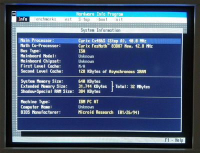

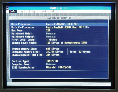

Just out of curiosity, I was trying HWiNFO 4.6.4 (I know it's too old, don't ask!) to compare to 6.1.3 on the CX486DLC CPU (well actually I have the TX version but they are basically the same CPU).
For the CPU itself HWiNFO 6.1.3 shows the correct and complete name.
But for the FPU, HWiNFO 4 shows the TM text on the FasMath name but 6.1.3 does not. Is this as expected? The FPU has TM in its name, for sure. It's even written on top of the ceramic package.
Also on version 4 the name of the BIOS is completely spelled as Microid Research while the new one is trimmed down. Again, is it as expected?
364.48 KiB
1656 views
393.65 KiB
1656 views
I have one additional question: regarding the differences in CPU vs. FPU frequency. I have noticed differences with the 386/387 pair as well. Is the frequency display inferred from some kind of software algorithm? And if so, can't it be made more accurate? It's not an issue by itself. But practically in these kind of systems, the CPU and FPU all run on the same CLK2 signal.

The trademark symbol has been removed in later versions, it doesn't make much sense to display this.
I will update HWiNFO to show full "Microid Research" BIOS manufacturer.
FPU frequency is determined by measuring time required to execute a batch of FPU instructions. This requires exact knowledge of FPU present and how many clock cycles the instruction takes. There's no other precise method available and if the FPU is not properly recognized or the amount of clock cycles not exactly known (which is often the case due to lack of detailed documentation), the result won't be correct.

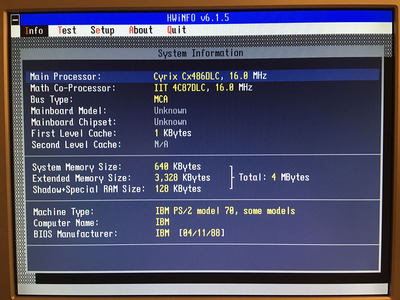

Reply 743 of 884, by andunn
Mumak wrote on 2021-10-21, 09:39:
I tried to adjust reporting of the FPU to show IIT4C87DLC and proper clock.
Those seem to be fixed, see results attached.

Reply 744 of 884, by Mumak
andunn wrote on 2021-11-01, 19:27:
Looks great, thanks!
