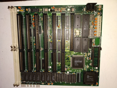

Hi,
when I poweron this motherboard I hear 3 beep without video output. On the keyboard I could see three led poweron and poweroff and after tha beeps.
I tried to replace the DIPP memories with another 286 worked motherboard but obtain same results (same chipset headland and CPU 286/16 harris). I tried only with anothe worked memory SIMM but same results.
Does anyone have any ideas?

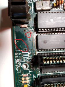

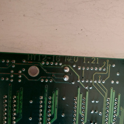

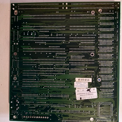

Badly corroded traces in top picture from the battery and also all along the top. 2 ISA slots on the right also full of leaked battery contents.
Bottom pic also shows corrosion of traces. Middle pic also shows further corrosion.
That motherboard looks pretty trashed to me, it'd be beyond my capabilities to repair if I owned it, but others who are more skilled with soldering could probably give it an attempt.

Reply 6 of 8, by mjnman
The three red line are good.
I removed two resistors and four pin jumpers and I found 7 traces around battery interrupted. In the red circle the traces.
Next days I'll try to repair.
Reply 7 of 8, by mjnman
I repaired the seven broken traces but obtaining the same three beeps error when started. I thinking there is a bad IC because when in the first time I powered blowed a capacitor. I think that I can put in the trash. 🙁
Reply 8 of 8, by quicknick
Old tantalum caps blow up all the time, they simply go bad and it's not an indication that there's a bad IC. Seeing that the corrosion is quite spread, it's more likely is that you missed one or more bad trace or via, possibly under the KBC, RTC chip or one of the first ISA slots. Can be a lot of work to diagnose, and almost impossible if you don't have a vacuum desoldering station. Still, I wouldn't put it in the trash; rather keep it for parts or give it away to someone who might be willing to try his luck.
