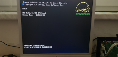

Hi guys,
I really appreciate the discussion that went on, I feel like this could be leading somewhere,
Anyways,
The mainboard bears a desgination REV:B3 right next to the CMOS battery
On startup the BIOS version that is reported is v4.51PG, and when in BIOS, it says 2A5LED4C (see pictures)
Anyways, I tried downclocking FSB all the way down to 66Mhz and run the CPU at 6x66=400MHz.
I also conntected the PSU to the ATX connector, rather than through ATX-to-AT adaptor.
I finally installed Windows 2000 and tried that with TNT2 Pro
Still the same, it does not work beyond 16-color retard mode (640x480 and 800x600),
I would appreciate if you could steer me to how to flash the BIOS in this board, is there a way to do it without the programmer?

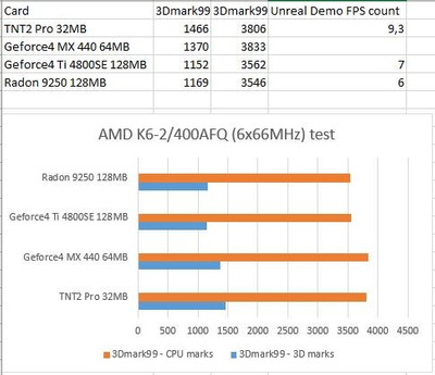

So after a few days of struggling, I have update worth sharing.
So primary improvement was brought by switching the option "assing IRQ for VGA" from "disable" to "enable" (default and failsafe option was "disable" for some reason).
After that, the system started kind of working, but random freezes and restarts stills occured. It turned out that apparently the SD card I was using was faulty in some way. After switching to new one and fresh install of Win98 (non-SE), I got it working nicely. Installing all the drivers for all the various graphics card I wanted to test worked just fine, no longer "retard 16-color mode only". I benchmarked the cards with 3DMark99 and Unreal Time demo to find the best fit, and during that, I found that the system still occasionally crashed when the FSB was set to higher than 66MHz. So in the end, 66x6MHz for the CPU clock it is. Installing AGP drivers wierdly did reduce the performance somewhat.
What seemed surprising to me is that even though I expected the CPU to bottleneck the system, the but resulting scaling was kind of strange,
37.54 KiB
158 views
I am going to add to the mix a TNT2 M64 AGP card, and hopefully Rage 128 Pro to see where they fall
