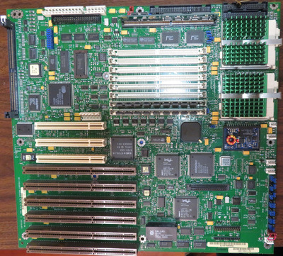

How many memory slots that can take double density modules are on your board? If more than 4 then there must be some buffering involved.
The 430HX chipset has actually a duplicate copy of MA signals which optionally allows for direct connection to SIMMs (without buffer) and maintain x-222 EDO burst performance on 6-8 SIMM socket motheboards when less than 4 SIMMs are used. However, not every motherboard used this. My GA-586HX does. The HX chipset was a weirdo and often deployed in servers where having more RAM was more important than performance.
AFAIK there are also HX boards with DIMM slots (EDO only) and they are always buffered resulting in x-333 fastest timing.
A photo of the board is provided below.
1.64 MiB
377 views
There are 8 SIMM slots and 7 buffer IC's between the SIMMs and chipset of part number AA244A. The IC's to the left of the SIMM slots are of various 7400 series types. The board works with up to 64 MB double-sided SIMMs. But for the EDO-FPM comparison, I've used singled sided SIMMs for both.

Reply 22 of 36, by mpe
I think you can take it as granted that this board with 8 SIMM slots must use buffered RAM signals to stay within specs. The string of small chips just under SIMM slots is #1 candidate for me (can't read markings). Whether this board also supports buffer bypass ( to enable x222 EDO timing for 2 or 4 row config) is something I don't know.

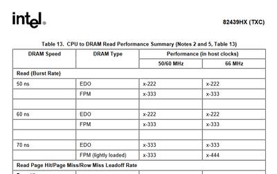

Reply 24 of 36, by GL1zdA
feipoa wrote on 2020-03-23, 07:26:
In the case of FPM being installed, the memory read burst timings are shown as x222 / x333 in TweakBIOS.
When EDO memory is installed, the memory read burst timings are shown as x333 / x444 in TweakBIOS.
This might be an explanation:
11.85 KiB
353 views

Reply 25 of 36, by mpe
Yes 244 series is a 8 channel buffer.
It has propagation delay between 2.5 - 7 ns and output enable time between 2 - 8 ns which increase effective RAM access time.
I think the chipset could be trying to compensate for these delays by increasing the cycle time.
These delays should apply to FPM too. However, perhaps the FPM with less aggressive timing still manages to stay within specs somehow? Not sure.

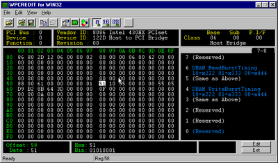

Reply 27 of 36, by GL1zdA
I don't have a 430HX at hand, so I'm just doing it in PCem emulating 430FX, but the "experience" should be similar.
1) Load the *.PRC file.
2) Go to 0x58 (white box with 0x51 in the screenshot). On the right you should see what the bits mean (the PRC is just the description).
13.07 KiB
324 views
3) Click edit. Change bits 6, 5, 4 and 3. WPCREDIT will highlight the description what you are changing. I assume for your case you will change x0101xxx (x are the irrelevant for this case, leave them as they are) to x1010xxx.
4) Now Set and confirm with Yes.
I don't have a physical machine to test it, but the chipset might as well totally ignore it, when the PC is running in protected mode (and that's the case with Windows).
Reply 28 of 36, by feipoa
GL1zdA> Thank you for the additional instructions. I had never used WPCREDIT before, or at least I have no memory of it.
Looks like the BIOS address 0x58, bits 6 and 5 are for memory read burst timings, while 4 and 3 are for memory write burst timings. 4 and 3 were already at 1 and 0, so I just needed to set 6 and 5 to 1 and 0.
The system did not hang when saving this register and I was able to benchmark the difference. I am using Sandra99's memory benchmark, which showed 84 / 111 MB/s for CPU/FPU before the change and 92 / 127 MB/s after the change.
I also tested this in W2K and it jumped from 81 / 107 MB/s to 88 / 122 MB/s for CPU/FPU. CPUmark99 jumped from a score of 12.7 to 12.9.
