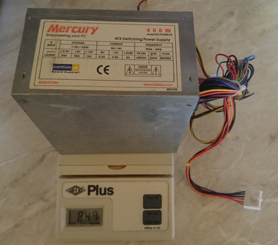

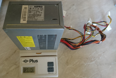

Reply 5 of 26, by Miphee
The weight of the unit is a telltale sign of quality.
Hipro 250W PSU (supplier of IBM): 1715 g
Mercury 400W PSU: 847 g
It's not a 100% bulletproof test but it's a start.
