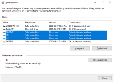

kolderman wrote on 2020-05-07, 22:25:
I prepare and maintain most of my retro HDDs on my modern Win10 PC. They are all installed in hot-swap drive bays, so I just take them out, put them in a USB HDD dock on my modern PC, and I can format/backup/restore them, TRIM SSDs etc. Much easier than trying to make stuff like TRIM run under Win98/DOS.
So for Win98 the process is simple - just format an SSD as FAT32, copy on the WIN98 folder, then boot using a CD or floppy, and then run setup directly from the HDD.
Partitioning can be easily on a modern machine, but as far as I know Windows 7 and 10 do not support TRIM on FAT32 filesystems .
The selected filesystems are FAT32 and are on a Samsung 860EVO SSD connected directly to a SATA port . Optimization is not available for them .
22.45 KiB
568 views
See also https://docs.microsoft.com/en-us/windows-serv … fsutil-behavior which does not mention FAT32 anywhere .
To query the system to see if TRIM is enabled or not, type:
fsutil behavior query DisableDeleteNotify
This yields an output similar to this:
NTFS DisableDeleteNotify = 1
ReFS DisableDeleteNotify is not currently set
To override the default behavior for TRIM (disabledeletenotify) for ReFS v2, type:
fsutil behavior set DisableDeleteNotify ReFS 0
To override the default behavior for TRIM (disabledeletenotify) for NTFS and ReFS v1, type:
fsutil behavior set DisableDeleteNotify 1

kolderman wrote on 2020-05-07, 22:54:
Sorry I only TRIM the ssd from a WinXP box with NFTS, but I am still able format and maintain Win98 SSDs this way.
No need to be sorry. Even the Wikipedia article is ambiguous on the matter . It would be nice if Microsoft were more up front about this .
