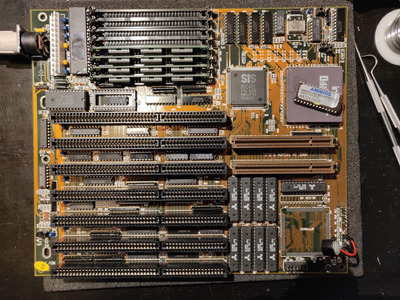

I have a motherboard that looks a lot like an Abit AV4 (http://www.uncreativelabs.de/th99/m/S-T/35060.htm).
The board does not POST, does not beep and gives no POST codes .
I have attached the image of the BIOS that came with the board, and I think it might be the wrong BIOS.
Does anyone have an Abit AV4 BIOS image I could try?

The bios ID string in your file is 40-0101-001133-00101111-111192-SIS461. the 1133 relates to Micro Leader Enterprises. According to Wims BIOS it should be 1247 for Abit.
It is possible it is the right bios as Abit did have some boards made by other manufactures, specially the older ones. There is no identifiers on the board itself that show the Abit logo.
Unfortunately I cannot find a BIOS for the AV4, just the AH4 and AN4R2. Maybe someone else will have better luck,

Reply 3 of 19, by PC Hoarder Patrol
Did you notice that the board in the PC Rebuilding link uses the SiS460 rather than the 461 chipset, and there are differences in some of the IC / socket layouts as well. Your board looks more like this one
https://translate.google.com/translate?hl=en& … 687&prev=search

Reply 8 of 19, by H3nrik V!
Would the lack of a BIOS battery prevent it from powering up?
By the way, I see some green residue at where the battery has been. Are all traces intact?
Reply 9 of 19, by Cyrix200+
H3nrik V! wrote on 2020-03-27, 06:39:
All traces look fine (visually), and I have checked continuity and I cannot find anything wrong. I tried powering on with an external battery pack.
The PSU spins up and keeps spinning, but there is no further activity. No POST code on the POST card, no beeps.
Another thing I can check is the tantalums for shorts, although I would expect that the PSU would shut down with a short. Not all tantalums near the PSU connectors are the same, maybe somebody already replaced some? It wasn't me.

Reply 10 of 19, by Cyrix200+
Since I worked from home today I could do some tinkering.
- Changing the BIOS does not matter
- I thoroughly checked all connections where any acid damage was visible. I de-soldered the keyboard connector to check underneath. Everything had continuity. Two vias are nasty though, they do connect from top to bottom. I let them soak in vinegar for a while and cleaned them off again. No change
- Removed all cache chips, no change
- I notice on my POST card the reset line stays high. Not unexpected I think?
- When I press the reset button and hold it, the PSU fan slows down a bit
- Voltages on CPU socket and ISA slots seem fine. 5V is 4.8V, but I think that should be acceptable.
Any thoughts?
