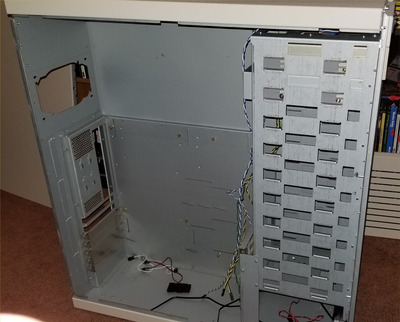

I bought this new old stock AT/ATX Steel Case recently. It appears to have been sold in 1999, but it looks older to me. It is all steel construction. Most cases from this era are steel, but this has got to have the thickest gauge steel I have encountered in a computer case. It weighs 37 lbs empty!
It is nearly mint, except for one ding near the top front of the case.
I would love to use it for a sleeper build, but there is one problem. There are literally no exhaust ports in this case! I'm fairly certain a modern system would overheat as-is. It's kind of funny that the advert for this specific case says that it has extra cooling. I would strongly disagree with that statement. They must be referring to the two 80mm intake fans.
If you look at the pics, the plate at the back of the case where the power supply attaches has a space above it that would fit up to a 92mm exhaust fan rather nicely. The only problem is that I would need to cut a hole for the fan and the screws. I have no tools that can do that cleanly.
Does anyone have any suggestions on how I can get a fan mount cut into that panel? Is there a person or a company I can use that will cut it out for me? Any help would be appreciated. Thanks!

You need to modify the rear panel above the PSU to have 120mm fan venting out. This case is poorly designed for cooling.

it looks like the PSU plate and the plate above that are removable and actually just screwed in at the back?
if so you could easily manufacture (or let someone do it) a plate to go there instead 😀 and you wouldn't even have to sacrifice any original parts.

Yes, it is removable.
I have no doubt it would be easy to manufacture a custom plate if I had a CNC machine or a water jet machine, but, sadly, I have nothing like that.
Any suggestions on any services available in the USA that could do such a thing? I have no clue.

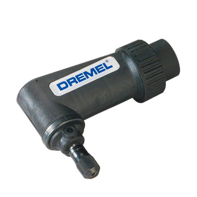

Right angle adapter:

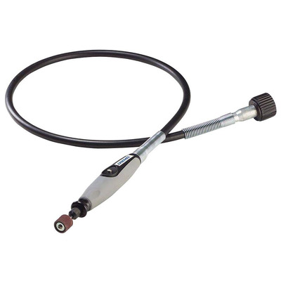

Flex shaft depending on location of cut - I have the original one that doesn't have the "comfort grip":
