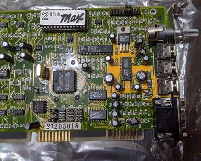

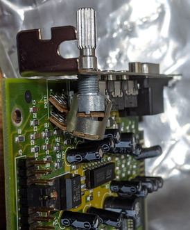

Mine arrived today. Unfortunately the volume pot was either already damaged or was damaged in shipping.
I already contacted the seller and I already order some new pots with volume knobs as well.

That's no good - was the outer packaging damaged? That does sort of look like it could be bent back into shape, if you're getting a replacement pot that might be worth a try to get it up and running now.

The circuit board material on the front potentiometer is broken in half. No way to fix it unless I drill the shaft to get it apart and even then I kind doubt it would work. Not sure about the back circuit board.

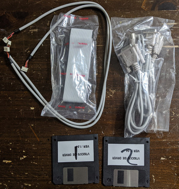

I'll take a pic of the hilariously not original disks that came with it after I reboot and see if I can actually access them.
Edit: So here is the pic of what came with my card. Documentation is completely missing. Just sent the seller another message about that and the fact that the contents of the disks are not even for this card.

And I got that same set of copied disks in one box, it's the SoundMedia Pro drivers. With the physical attributes of the card, and the poor sound quality it really seems like these cards were a rush job by TNC for the vendor.

The fix should be fairly simple as the pot used is a really common one and was easy to find. If TNC had actually installed the washer and nut for the pot on the card in the first place it would have been immensely harder for it to be damaged.
The new pot will have the washer and nut installed as well as a knob... though I am pretty sure the knob will not be able to be installed until after the card is installed as it looks like it will interfere with the card slot in the back of the case because the shaft is very near the edge of the slot instead of centered.... probably was made that way because the standard size pots were much easier to get and probably way cheaper than weirdly sized pots.

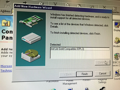

I popped in the card into my 98SE 440BX system and did the Add New Hardware search for non-PNP hardware. I was happy to see this pop up:
793.96 KiB
1084 views
Haven't messed with the driver disks yet. Duke3D works with Adlib music and listening to Tyrian 2000 jukebox right now. Sounds good!

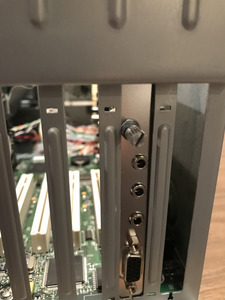

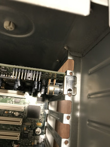

The pot and volume knob really are non-standard. The knob keeps the top of the slot cover from moving over the screw hole, so my card is not secured to the case.
