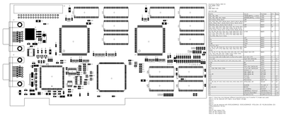

Voodoo 2 component map
First post, by sdz

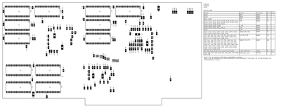

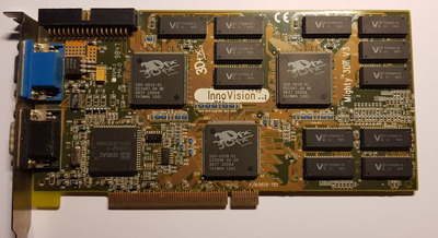

1. INNOVISION_MIGHTY_3DII_V3
303.43 KiB
1872 views
244.55 KiB
1872 views
614.43 KiB
947 views
316.46 KiB
1872 views
PDF versions are attached in the next post.
There are many other V2 cards with the same layout as the InnoVision Mighty 3DII V3, component values from this card can be safely used.
I hope making a few reserved posts isn't against the rules, I plan to add more info at a later date.

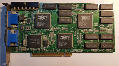

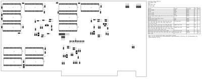

2. CREATIVE CT6670
538.48 KiB
943 views
486.95 KiB
943 views
645.91 KiB
947 views
284.25 KiB
944 views

Hi!
On what basis did you determine capacitors capacities 1206 C3, C4, C17, C35, C37, C43, C45 on the 5V line?
I measured the capacities and received divergent results
C3 = 3147nF
C4 = 3147nF
C17 = 3200nF
C35 = 3146nF
C37 = 3117nF
C43 = 3166nF
C45 = 3147nF
I suspect that a new capacitor with a capacity of 3.3uF than 4.7uF would be more suitable here, although I know that it does not matter much for the work of V2. I used 2.2uF capacitors and the card works stably. The other capacities you provide in the table are the same. Voodoo2 cards are very tolerant of lack of capacitors, they work properly even without them.
Reply 15 of 27, by sdz
Hi,
I used an LCR bridge. In my case, the measured values were closer to 4.7uF than 3.3uF. Some variation is normal, some manufacturers modified the reference design a bit (the card shown in the first post has polarity markings for the 1206 caps and uses ceramic caps, some manufacturers used tantalum caps there), or just used what was cheaper in that production run and was in the right ballpark.
Either way, the value of these bulk decoupling caps isn't critical at all (in fact a modern 1uF X7R may be better than the original 3.3-4.7uF caps ).

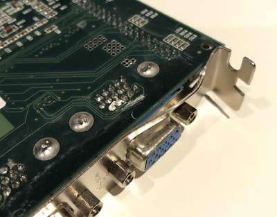

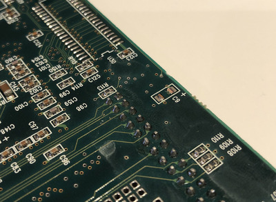

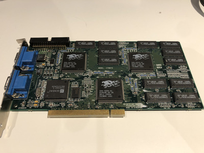

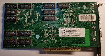

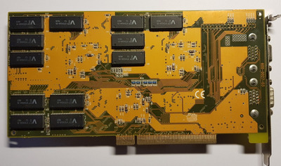

I just got a banged up Creative CT6670 Voodoo 2 on eBay. I had to straighten quite a few legs on all three chips, but all appear to be good now. There is also some trace damage it seems near the VGA connector. I fixed some of the solder damage there. From what I can see, only one surface mount capacitor is missing (C9) as pictured. It is located at the back of the card behind the SLI connector. It doesn't seem to be present on the reference design in the OP's diagrams. Any ideas what this is for or if it could be contributing to my problems? Any idea what this should be or if there is there a 'safe' capacitance value I could try here just for troubleshooting purposes?
The card is detected fine in Windows 95, drivers install properly etc. I get no video output at all (passthrough or otherwise). The system locks up when trying to go to the voodoo tab in display properties.
    446.2 KiB
    1127 views
    Creative CT 6670
    331.81 KiB
    1127 views
    Damaged traces?
    438.87 KiB
    1127 views
    Missing C9 capacitor
Reply 18 of 27, by lemonlime
sdz wrote on 2020-08-13, 06:51:
C9 on your card is a 3.3-4.7uF, minimum 6.3V, 1206 cap. You're also missing C48 (top side, bottom right corner), this is a 1nF 25V 0603 cap.
Awesome! Thanks so much sdz. Good catch on C48, I totally missed that one. Now that I'm looking more closely, I see a few more:
1. C128 is missing from the top left on the back of the card. I see that one in your component map (100nf 25V). My card is only 8MB so thinking C128 may not serve any purpose.
2. C81 is missing. Also in the component map (1nf 25v)
3. C108 is missing. I don't see this one in the component map. Any ideas for this one?
Here are a couple of higher resolution images in case you can spot anything else missing or damaged:
Front of card:
https://vswitchzero.files.wordpress.com/2020/08/img_2368.jpg
Back of card:
https://vswitchzero.files.wordpress.com/2020/08/img_2370.jpg
Going to try to replace these and see what happens. Think the absence of these could be the cause of what I'm seeing? I hope the trace damage near the VGA output isn't the cause.
