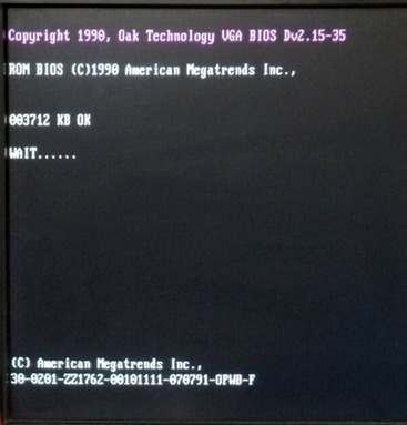

Deksor wrote on 2021-02-25, 00:05:
Were there any other photos on that listing, like POST screen photos, etc ?
as a matter of fact there were:

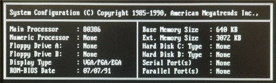

the second picture doesn't really show anything, but does that string under the bios help?
evasive wrote on 2021-02-26, 12:40:
yep that's the same as I linked above, we already concluded that j-mark = jetway I guess ^^

Reply 21 of 24, by Deksor
Thanks ! The first photo was the most useful. In it there's the "POST string" (that "30-0201-ZZ1762-00101111-070791-OPWB-F" thing) which gives some details about the board and among them, the brand.
Oddly enough, this one "says" that this board have been sold by "ansoon technology co.". Now both Jetway and Ansoon were taiwanese companies, so they may be related or even be different names for the same company, we've seen that before far too often x)
