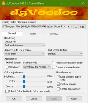

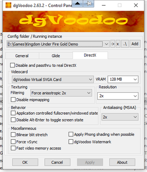

Gotta Experiment with what works on your hardware, I can't do that for you but happy to help with suggestions.
But here's the settings that I've used:
(I'm not using any compatibility settings in windows at all, I'm also using the full game and not the demo(don't know if that makes much difference))
73.7 KiB
1120 views
General Settings Tab
76.28 KiB
1120 views
Dx settings Tab
alt + enter messes with the mouse when windowed mode is forced in dgvoodoo, maybe some combination will work for you but the game wasn't desgined for this, one thought it's not a massively demanding game, so it might run in an emulator which would allow full screen and windowed without messing up the mouse / screen input, just another thought. I might try it under Linux/Wine.
Reply 10 of 10, by ruthan
Im using demo just for testing, beside full game where i want just copy working settings.
I tried lots of settings, but i always had double cursor with offset problem, what very annoying.. but i finnaly find the mod, where its working fine, probably without any dgVoodoo enhancements.. U have i in DirectX tab, use checkbox Disable passthru to real DirectX.
Update: Hmm, but after ALT+TAB is not working.
