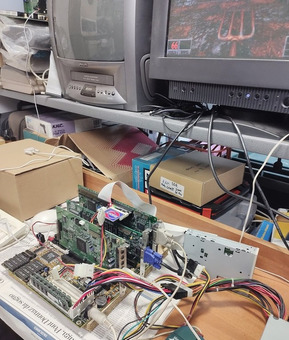

I've tested again this motherboard: same AMD DX4, 16mb ram, CH-300 scsi/ide vlb controller, vlb video card, CUTE MOUSE mouse driver, sound blaster 16 (a pnp model, but dos drivers are great and compatible)
Microsoft home serial mouse.

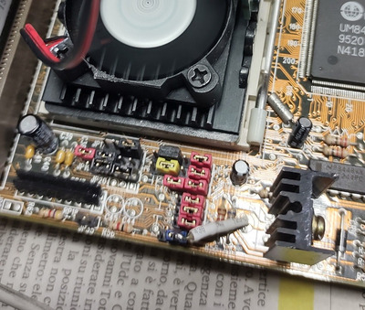

Those are the jumper settings (untouched since last time)

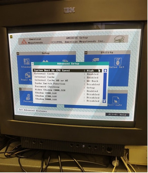

Those are the BIOS settings
109.67 KiB
1037 views
I've tested it with doom and Blood, and mouse works with both of 'em. No problems whatsoever.Heck,mouse even works in BIOS...
Good audio, good video, good controls.

Thanks for your reply. My jumpers settings are exactly like yours, except that I soldered JP20 to enable the clock multiplier 4x for the 5x86 processor.
As for the WB option in the BIOS, this item does not affect anything at all. The caching mode is set only by jumpers.

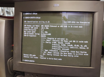

Either my board is a little faulty, or it works like this with AMD 5x86. I want to find DX4 SV8B and check with it.

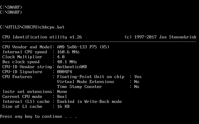

Have you checked whether the L1 cache Write-Back mode is active? This can be checked using the utility CHKCPU: http://web.inter.nl.net/hcc/J.Steunebrink/ckcpu126.zip
Yes I did check and it's enabled
159.16 KiB
1001 views
Just to experiment a bit, I've tried to change it to write through in bios, but results enabled in write back anyway. If I disable the internal cache in bios, the program reports it.

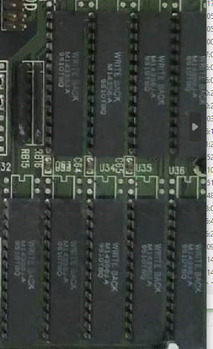

Dear Sirs, I got recently a PCChips M915i motherboard . According with the info written in the motherboard (see attached picture) I can use this mobo only for DX4-SL and P24D processors.
P24D is a Intel i486DX2 Write Back but I have a 80486DX2-66 (SX911) and this Processor does not support write-back.
