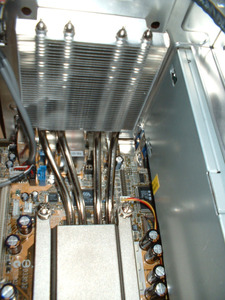

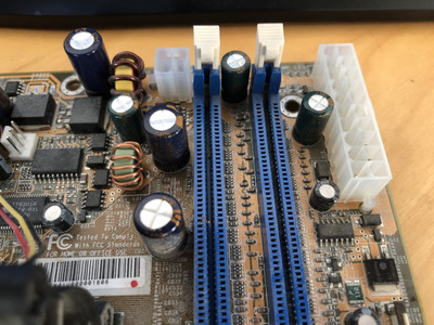

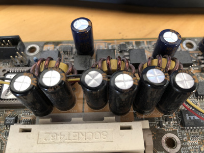

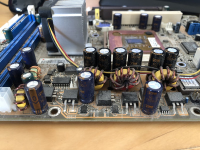

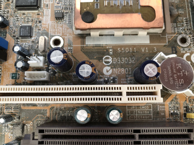

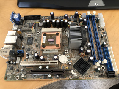

I'm after some help with attempting to repair the above board. Normally I'd just replace boards like this, but trying to track down a replacement on eBay was difficult (I only found one viable replacement and I'm now using it). This board isn't a standard ITX so if the replacement fails, it's curtains for the PC using it so I'd like to try and get this fixed.
Symptoms are:
1) On powerup, the power LED, HD LED stay lit (full) and the fan spins up to full power.
2) There's no graphics output, either when using the built-in GPU or a seperate AGP card.
3) No beeps from the PC speaker.
4) The machine only powers off if you hold the power button in for 4+ secs.
Removing all other components (storage devices, PCI card etc) has no effect.
The memory, CPU and PSU are all known working components (I've tried spares without success, I've replaced the board with the spare and the machine happily powers up). I've inspected the board and to the best of my knowledge, I can't see any failed components:
1.26 MiB
1316 views
1.69 MiB
1316 views
1.53 MiB
1316 views
1.53 MiB
1316 views
I've got some basic electronic skills and repair tools (I own a multimeter and a soldering iron, I've repaired/replaced basic audio connectors before, but nothing as complex as this). Any recommendations on tools I should get, or things I should check with the board itself?
Are there any repair services in the UK who could do this kind of work, or am I best tackling it myself?
Any guidance or advice appreciated.

I'd be thinking that every one of those OST caps is a potential source of (open) failure without visible sign - are you up for the time & cost of a recap?
The time and cost doesn't bother me at this point, given the relative scarcity of viable replacement hardware. I don't mind whether I fix it or someone else does, as long as the board doesn't get trashed in the process.
Are the OST's known for failing without bulging? I've only ever seen caps that are visibly bulging/bursting on failed boards.

Brand-wise you'd be looking at Rubycon, Nichicon, Panasonic or UCC (United Chemi-Con). As to specific brand series, maybe someone more experienced with actual recapping might chime in on that.

Is this the FN45 V1.0 or V2.0?
And did you change the DDR voltage to 2.7v at any point? It is well known that changing this option can kill FN45’s within a short space of time. I think this was exclusive to V2.0 though. And it was the vdimm regulator that fried out. Shuttle in later bios revisions removed the option to adjust DDR voltage because of this. Working off memory on all of this

Check all the voltages you can. Make sure you have good 5V, 12V, 3.3V, 5Vsb, Vcore, etc. If you find a pinout for the DDR slots you can also check the ~2.5V that should be there.
Some voltages are easy to grab from an unused drive connector, but others need to be backprobed on the ATX and "P4" connectors.
Even if the board was booting I'd still suggest doing this with a multimeter because the readings from onboard sensors aren't reliable. It's common to have huge discrepancies from what a meter will tell you.
Typically Vcore is switched by a group of 2 or 4 or more MOSFETs near the CPU socket, and half of them will have Vcore at the large tab. The other half will have the input voltage there (5V probably).
You can also find Vcore at the inductor between those MOSFETs and the CPU, or on the positive legs of the Vcore caps. You can't assume that all the caps near the CPU are for Vcore, but it will be fairly obvious which of them are when you find a bunch of them in electrical parallel. To really confirm that you can also check for continuity to the Vcore pins at the CPU socket (have to find a pinout to do that).

My PCI tester card dropped through the post today, so I've tried powering up with it in the slot.
The display rapidly cycles through a series of codes too quickly to count, then stops on F6, which is PhoenixBIOS shorthand for "Boot to mini DOS". It never gets any further. Behaviour is always the same despite the CPU in the socket and whether I've put a DIMM in one of the slots.
I'll pull out my multimeter and start testing the voltage/current readings.
