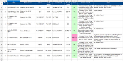

SUPPORTED FUNCTIONS PER CPUs:
354.32 KiB
1233 views

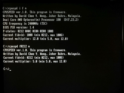

CPUSPEED will attempt to measure the CPU clock speed with the 'i' command.
This is done using Intel's textbook CPU frequency measuring algorithm,
utilizing the TSC (Time Stamp Counter). For newer CPUs which support the
APERF/MPERF (performance) counters, CPUSPEED will also report the PERF speed
measured using these counters. Please note that while TSC is supposedly fixed,
its implementation varies across CPUs/brands, and on some systems it will
vary when the CPU clock is throttled.

CPUSPD version 1.1 released. Resolve incompatibility issue with Yamaha's DSDMA sound driver. Please download from first post.
Sound card test results:
Please note that we are only testing the proper functioning of the CPUSPD program here. Some sound cards might experience stuttering on certain motherboards, due to poor implementation of the throttling function in the south bridge.
    253.34 KiB
    17030 views

One not so obvious features of CPUSPD is that it allows you to set the voltage of the CPU. By lowering the voltage when running at lower multiplier will reduce power consumption and heat generated by the CPU, allowing it to reduce fan speed and run quieter. The difficult part is that you must know the minimum required voltage for the corresponding multiplier. AMD CPUs have an advantage here over Intel as the min and max voltages are listed in the BIOS. In fact AMD pioneered this technology when they started introducing PowerNow! and Cool'n'Quiet (AMD called it Cool'n;Quiet for desktop CPUs and PowerNow! for mobile), starting from K6-II+ and AthlonXP. Intel only followed suit starting from Pentium 4 430 and called it SpeedStep (IST, Intel Speedstep Technology, later change to EIST, Enhanced IST), and their documentation on this is sketchy (perhaps afraid of lawsuit from AMD?). They do not have this info embedded in the BIOS as well, and to find out, we need to refer to the individual CPU's datasheet.
Here is the screenshot when AMD CPU (in this case an Opteron Dual Core 180) is used with the "f" command:
124.93 KiB
16674 views
P-states are the "power states" listed in BIOS. The first 2 digits is the multiplier in hex ("fid"), and the next 2 digits is the voltage ("vid") also in hex. Please note that vids are inversely proportional; larger value means lower votage, so 0212 has lower multiplier and voltage vs 1008. Caution: insufficient voltage will hang up the system!
One thing to note is how the value of fid relates to multiplier. For this CPU, the multiplier min is 5.0 and max is 12.0, while the fid min is 02h and max is 10h. This is because it's multiplier increments in 0.5. So we have 5.0, 5.5, 6.0, 6.5, 7.0, 7.5, 8.0, 8.5, 9.0, 9.5, 10.0, 10.5, 11.0, 11.5, 12.0. The corresponding fids are: 02h, 03h, 04h... 0Fh,10h, for a total of 15 steps.
Please note that to use this feature the CPU will either need to be unlocked, or support PowerNow!/Cool'n'Quiet/IST/EIST. This holds the same for the multiplier setting command ("m"). Also please note that the m command is a subset of f command - it just hides the voltage settting portion for users who don't want to be bothered.
- David W.
