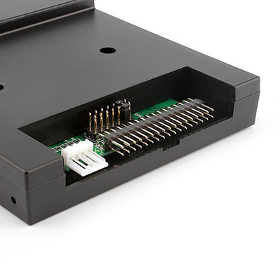

monsterbash wrote on 2021-02-25, 14:14:
ragefury32 wrote on 2021-02-17, 05:27:
That being said, I killed my UFA1M44-100 (the USB version of the Gotek) by triggering the unlock, and KeirF (the author of flashfloppy)didn’t even want to touch it (that is a dual controller board - one for handling floppy emulation and the other used for handling USB mass storage, communicating to each other via I2C or SPI). I also can’t find original Gotek firmware so I can at least unbrick it. He has a point though not supporting it with flashfloppy....no idea how a 1.72MB XDF formatted USB floppy setup might fare on, say, an oldschool Toshiba laptop with USB floppy drive support.
What's the difference between UFA1M44-100 and SFR1M44-U100K ?? By the pics on AliExpress I saw no difference !!!
Cheers !!!
43.62 KiB
262 views
SFR1M44-U100K
26.36 KiB
262 views
UFA1M44-U100K
It does? How is that possible?! AliExpress vendor pics are infallible. INFALLIBLE. It’s not like their vendors have a known history of plagiarizing from each other and talking out of their asses...

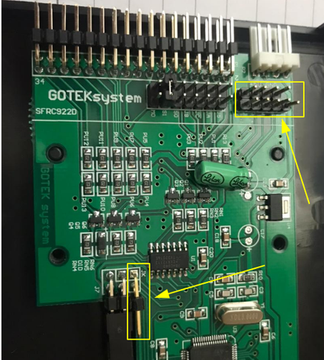

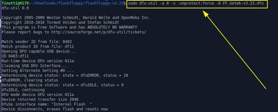

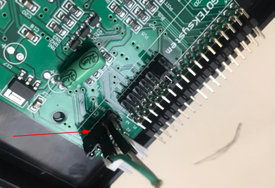

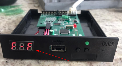

My GOTEK just arrived !!!
Here what I've done so far:
1) solder pinheaders for the "programing section" and for the "select" button;
2) jump wire pins for programming the unit using USB-A to USB-A cable;
3) plug the unit on computer using USB-A cable and <lsusb> command to see how Linux detects the unit;
4) command line <dfu-util> to unprotect the STM32;;
5) command line <dfu-util> to flash the unit with FlashFloppy;
6) power up the unit to see if everything ok - seems to be OK !!!
Now, I'm trying to identify the pinnouts from a rotary encoder pulled out from an old kenwood car audio...... 5 pins, but do not seems to be standard pinnouts...
